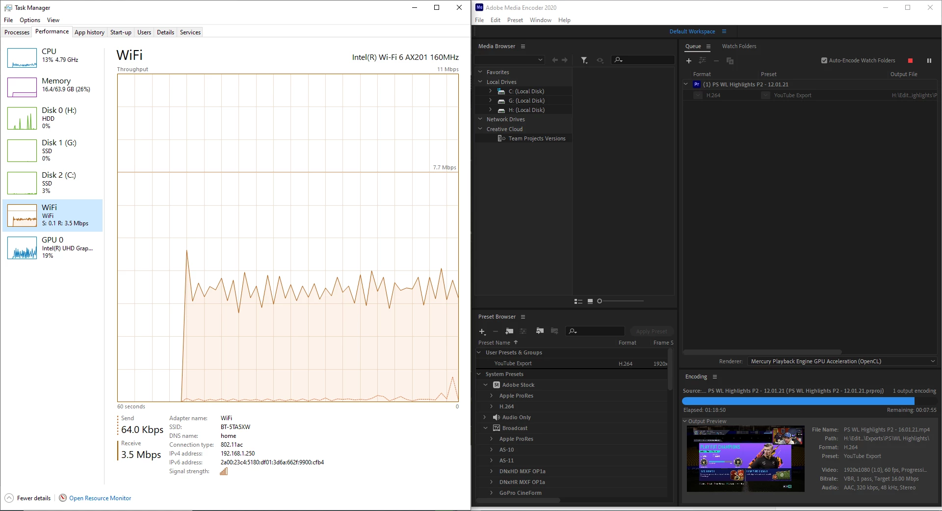

This image shows what I am seeing when I am exporting videos? Can you understand why I may query this?
March 11, 2021
Disconnect Youtube account from Premiere, it looks like the upload speed limits your overall export performance
March 11, 2021
Thank you for the response, will attach a screenshot but I'm pretty certain that it isn't connected to the YouTube account.
