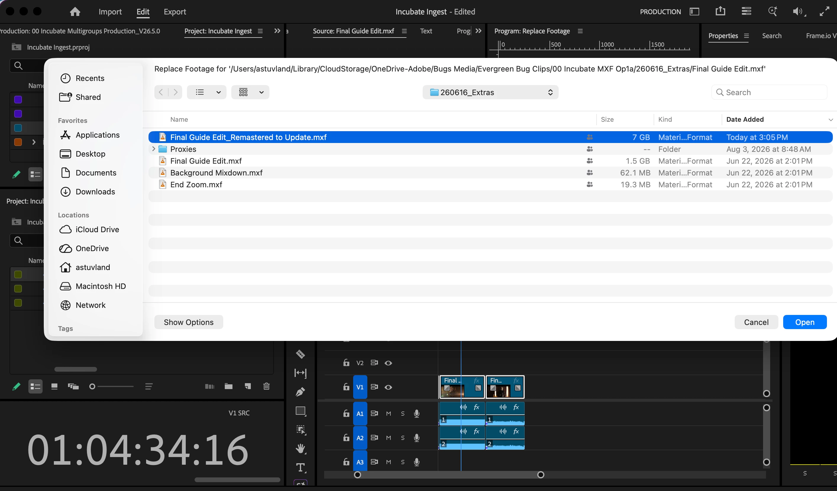

If you are versioning a clip, as in you had a previous Master you used in multiple spots within an edit, then received updated color, fx, etc, and wish to replace it throughout the Edit, the best practice would be to use “Clip → Replace Footage” from the Project window. This will Replace every instance of that clip in all edits, respecting the timecode.

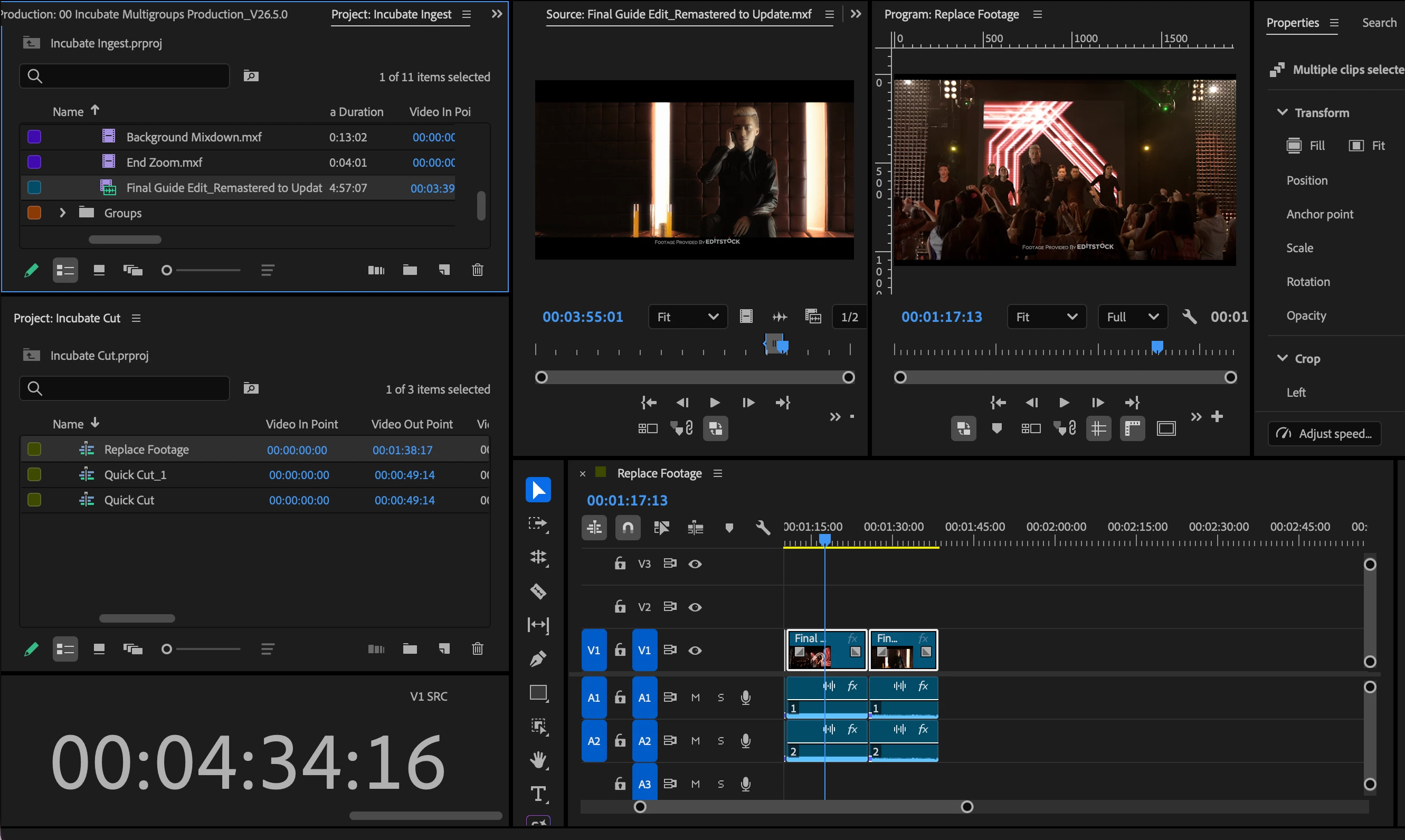

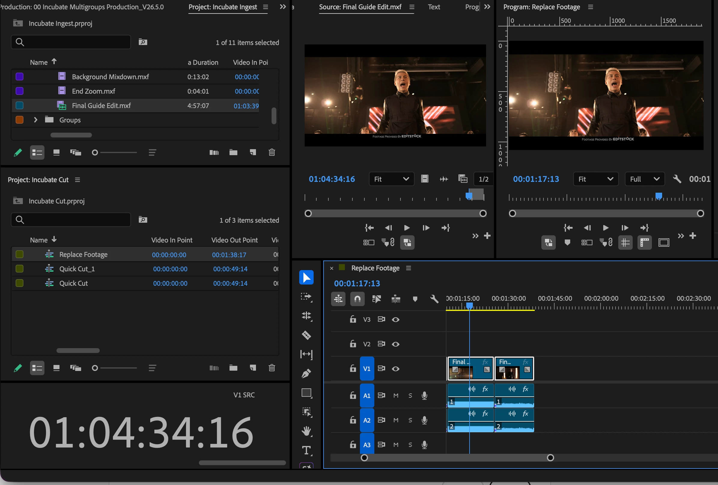

Original Sequence with Source TC Showing

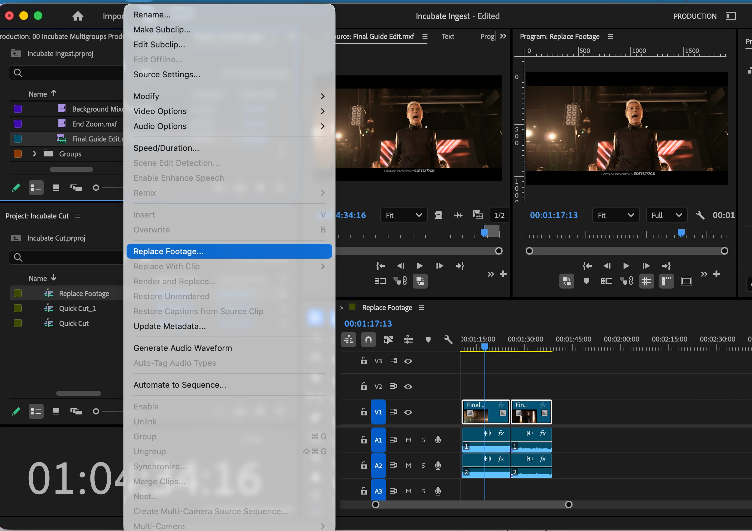

Clip → Replace Footage (Make sure you have the right clip selected in the Active Project Panel)
Select your New Master
Will maintain Relative Timecode. New Master had been exported starting at hour 0, but was the same total run time of the old version.
