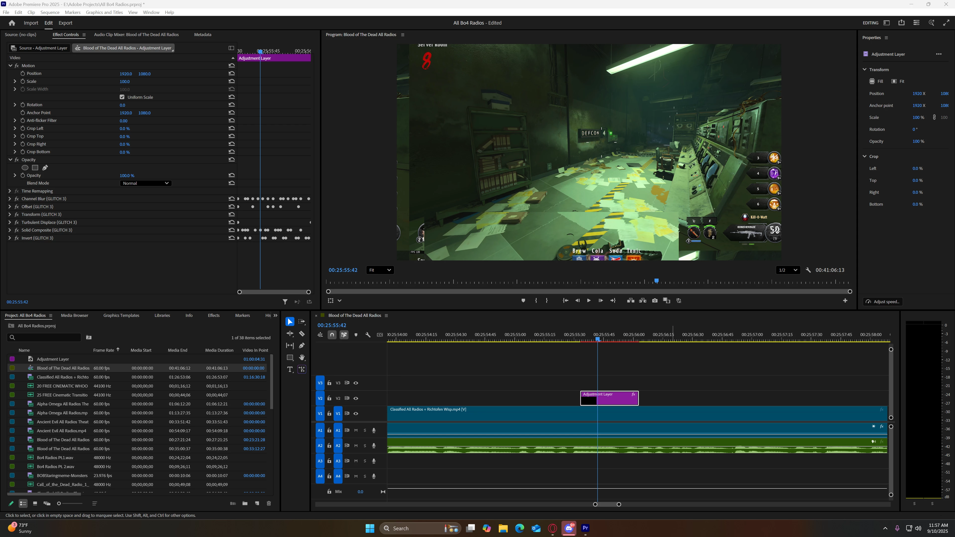

Why do my transitions work at the beginning of the timeline, then stop half way through?

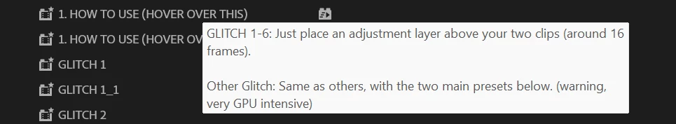

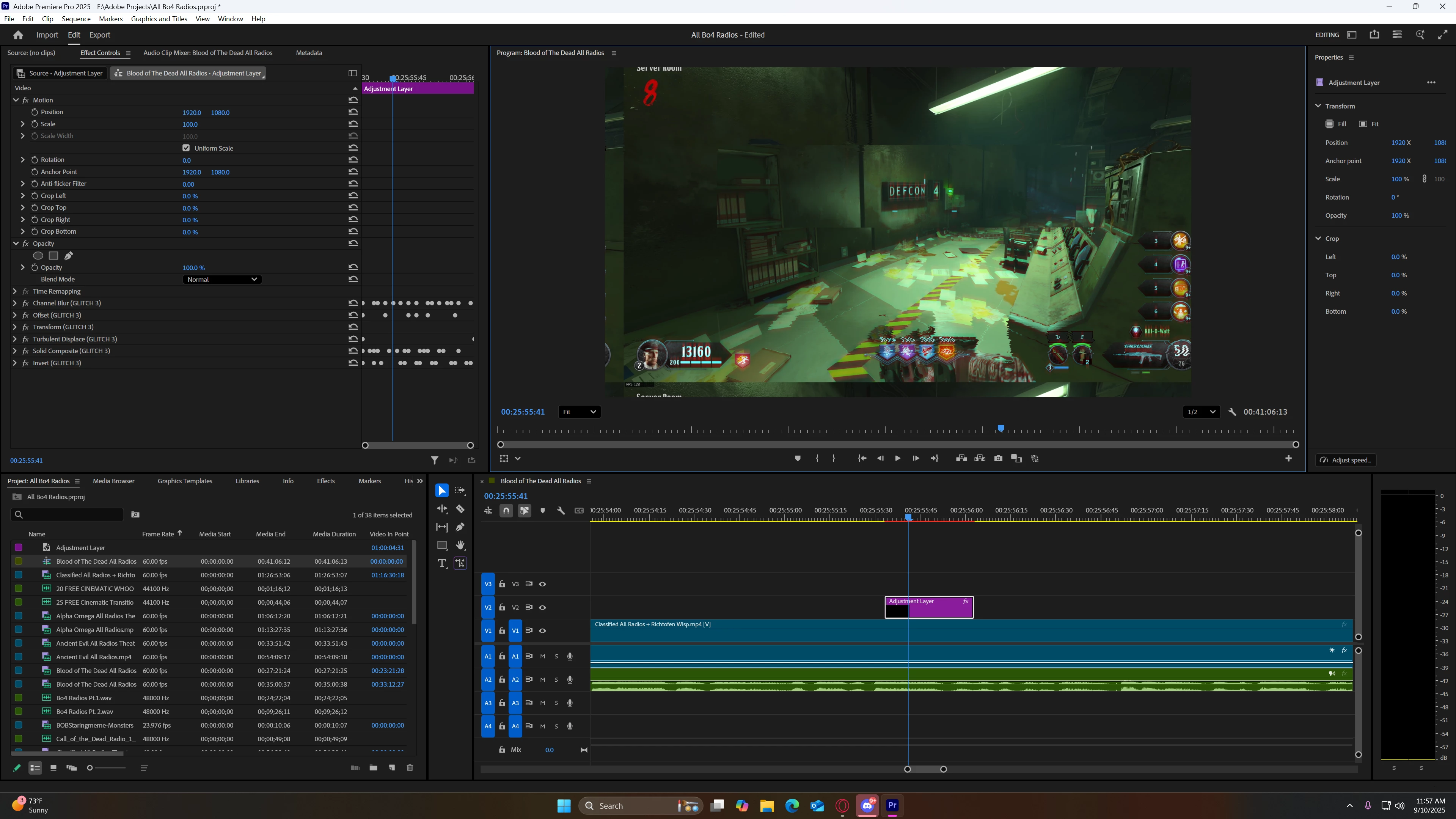

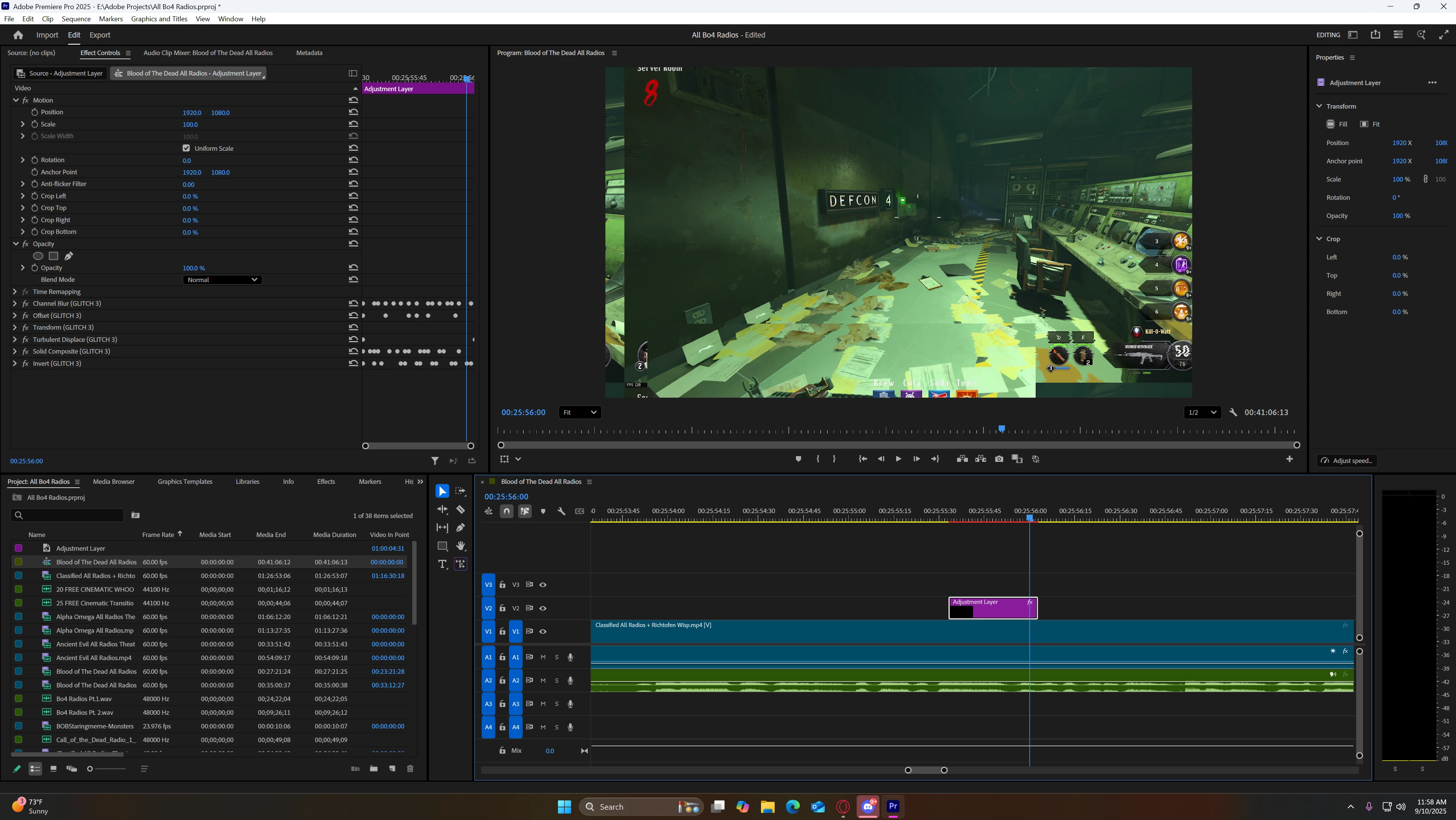

I am severely frustrated with premiere right now. I have some presets that I bought. The one I am trying to use is a "glitch" effect/transition, at the beginning of my time line the transition works as it should then 25 minutes into the video they just stop working, even though I have copied and pasted them as described to me in the written tutorial. I have even found the exact frame in the time line they stop working and all other attempts past that frame result in the same issue but before that frame they work as intended. what am I doing wrong, or what happened in the time line. I know in the screenshots it looks like im not transitioning to anything, but that was where I had found the issue starts and persists no matter what after those frames through out the rest of the video.

Firstly, I want to apologize, I should have tried to work it out a little more before posting. I ended up figuring out that it was a specific clip that I was using. When switching to a different game modes footage it sudenly started to work. I was able to figure out for the specific clip I wanted to use if I Nest the two clips with the transition there was no issue what so ever. I still am not 100% sure as to why there was an issue in the first place as I have an rtx 4080, and a ryzen 9950x3d, and every clip I have used was no less than 4k60fps. Thank you for trying to help and again I am sorry for the inconvenience.
