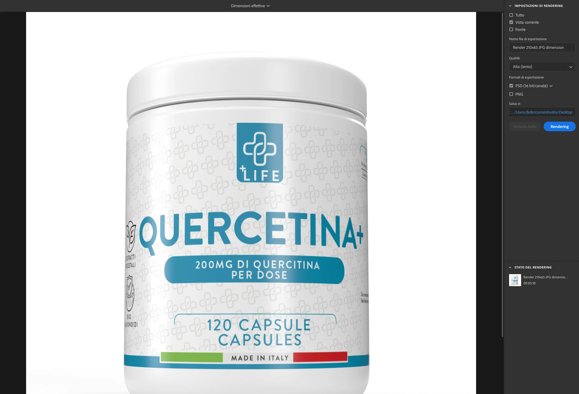

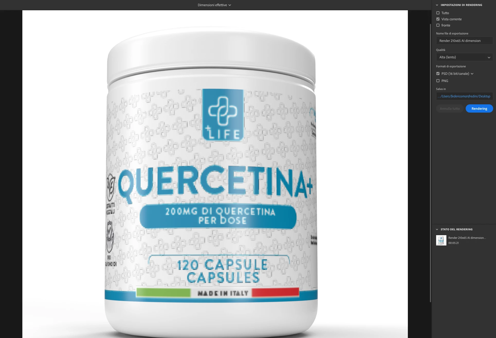

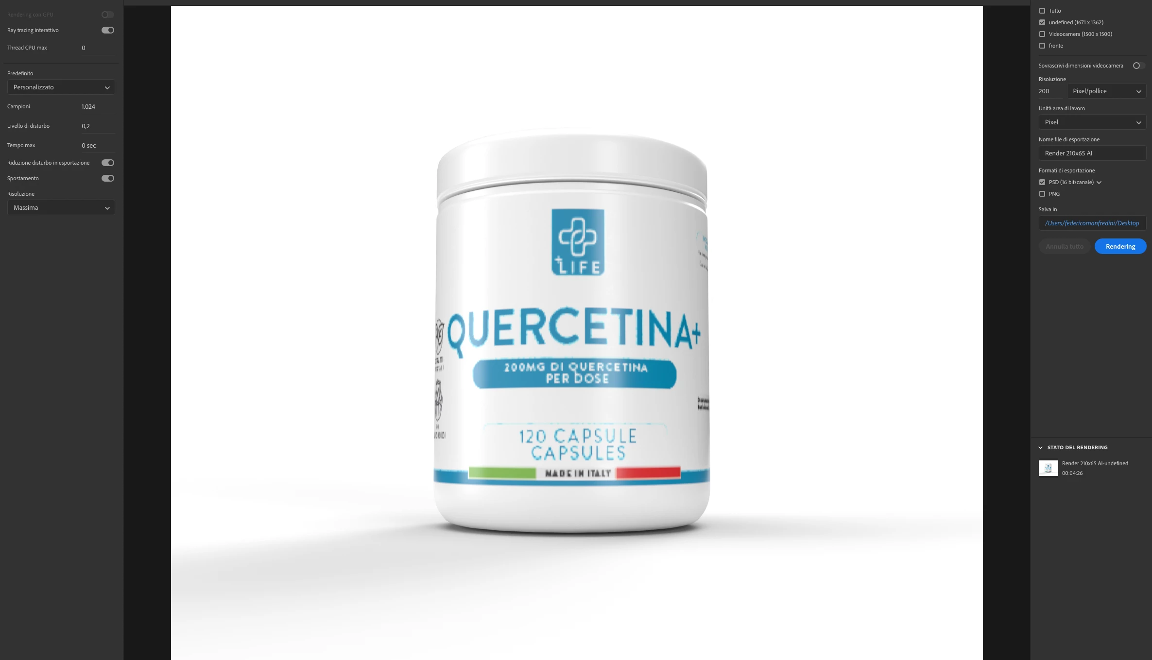

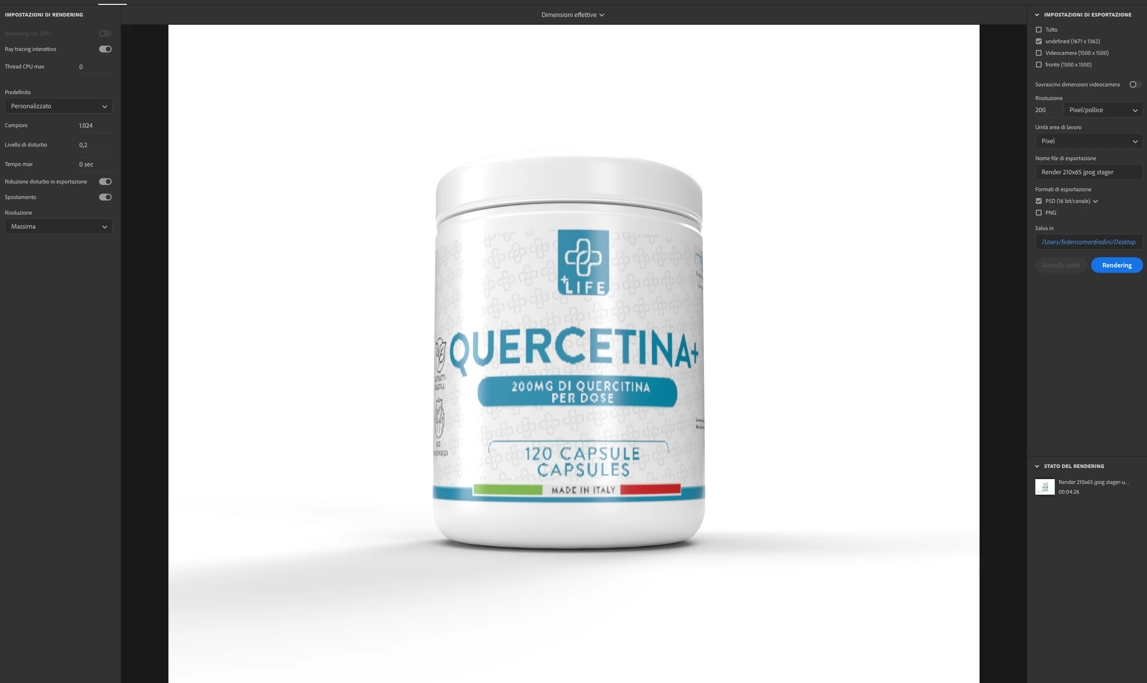

Goodmorning everyone!
If it can be useful, I confirm that the stager render, with the imported textures applied, is useless! I enclose example, same texture used in size and stager with the same model, first imported in ai format then in jpg format. In the screens you also see the render settings. Remembering that it is ridiculous that those who invest in an M1 MAX with 64gb do not have the possibility to use GPUs. I'll switch to blender!

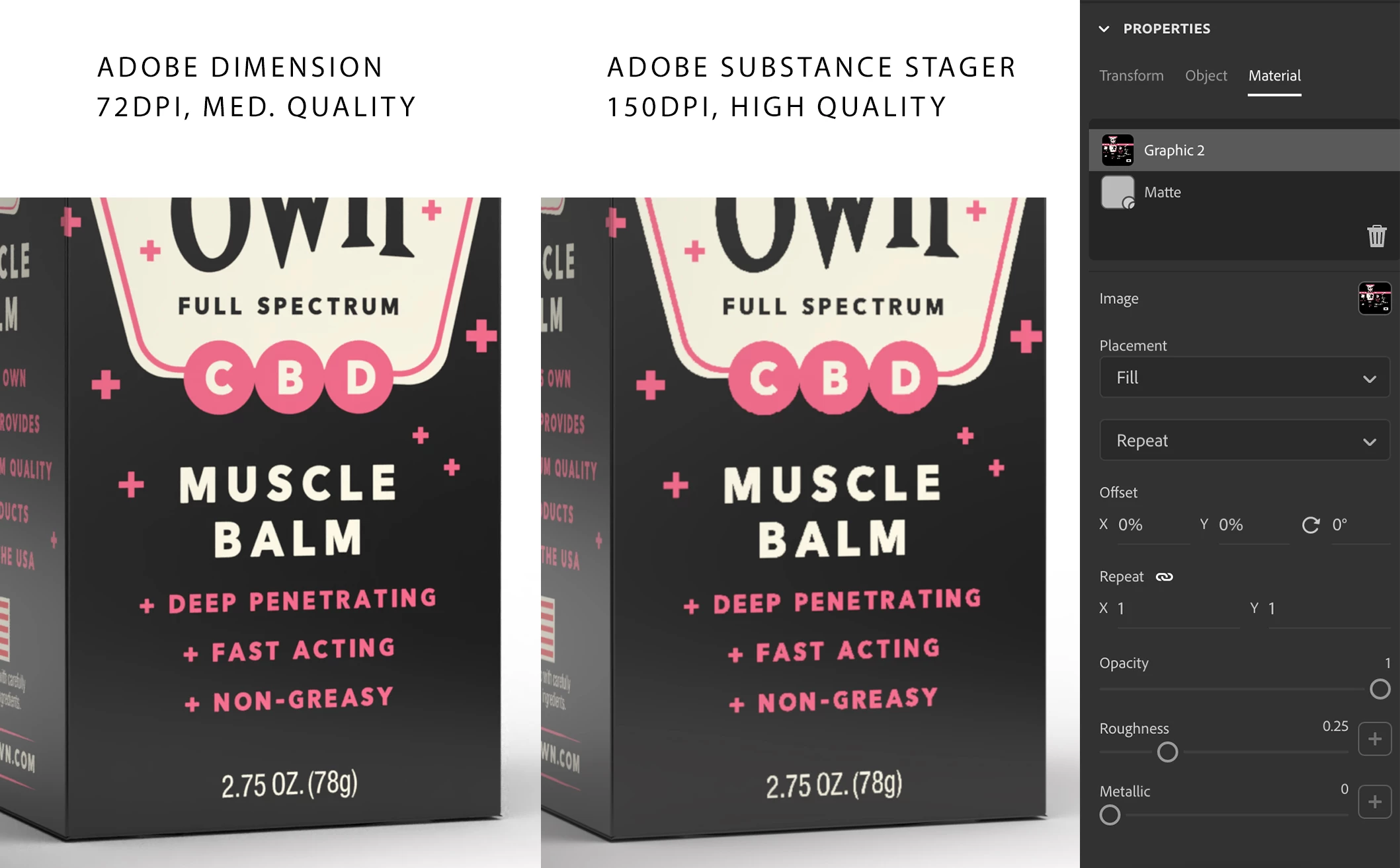

I have grown to really like Dimension for rendering packages so I thought Stager would really up my game, but wow this is BAD! I am experiencing the same issues as many above have posted - pixelated graphics, especially visible on type, on placed images.
As a simple test I opened a previous Dimension file in Stager and compared the rendered output. The file I tested uses a 300dpi PNG image placed to fill on a model of a box. All settings seemed to translate perfectly between Dimension and Stager but the output is night and day, see image attached. On the left is the file rendered by Dimension at medium quality and 72 dpi. I used the same settings in Stager. Unhappy with the results I upped the stager settings to High and 150 dpi – Still, the lower quality render from Dimension is superior.

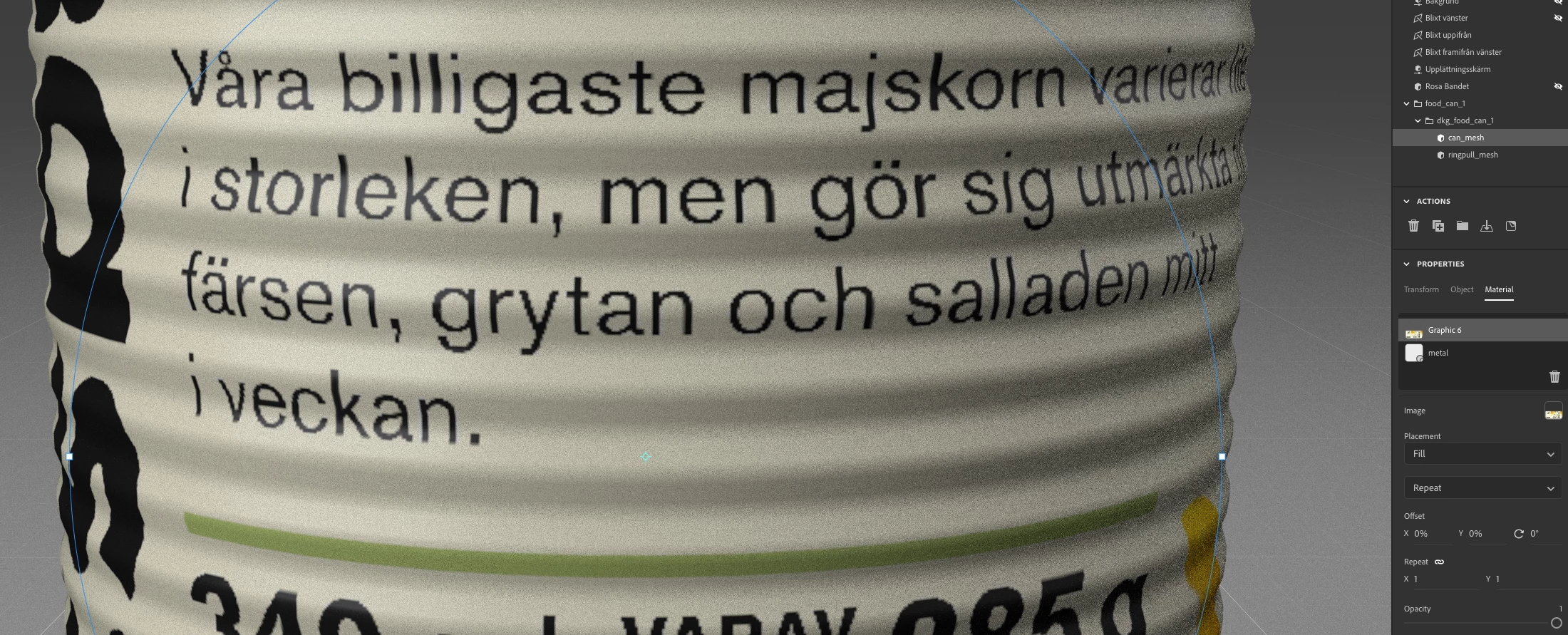

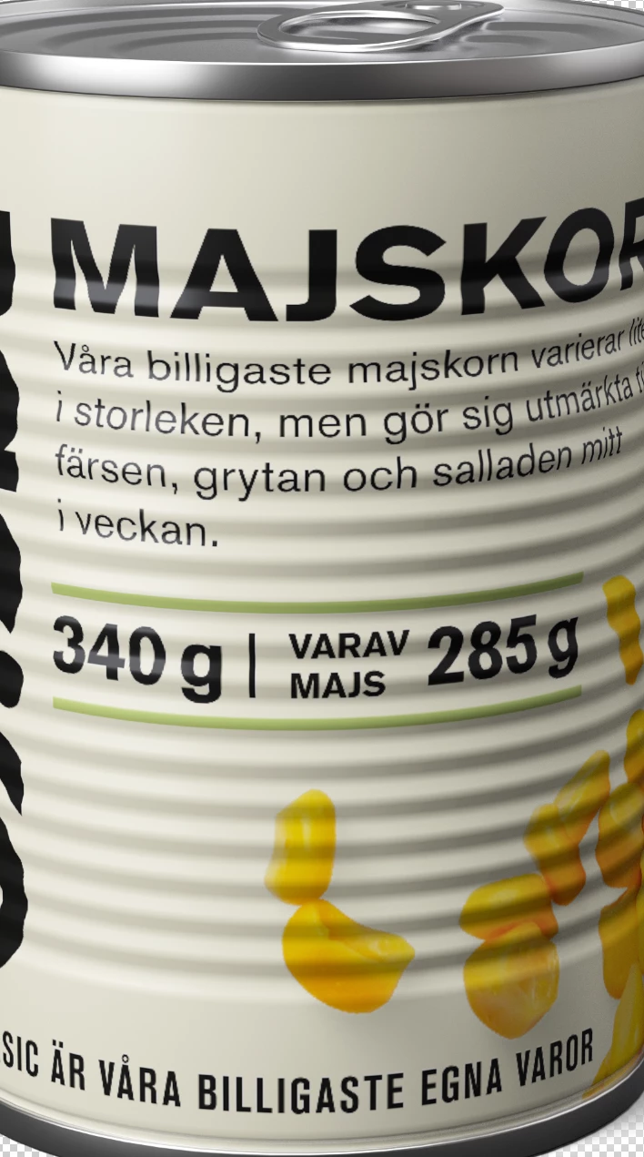

Hi!
When I place an image on a model i get pixelated text. I've tried all imaginable formats on the artwork, and also different resoulutions. All with the same issue (see attached files)
I've found that this was an issue in Adobe Dimension. Is this still not resolved in Stager? Any workarounds?
Kind Regards
/Marcus

Usually i correct this in rendered Ps file adding sharpening. That can be a workaround...
Mar 22, 2022 8:24 AM UTC
Ares, it gets even worse with sharpening and blur makes it.......... well blurry 🙂
