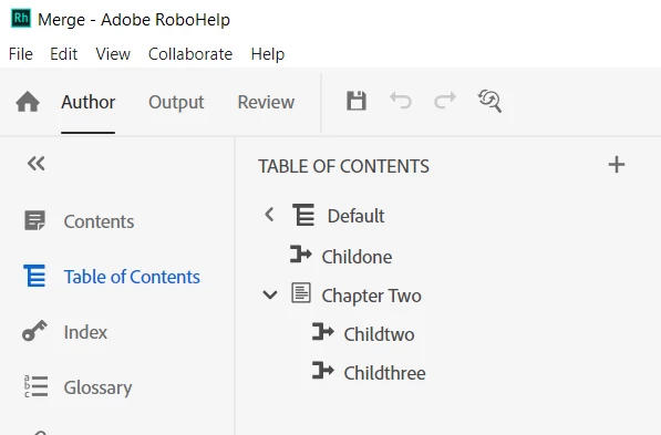

    I've got this going on in my parent project:

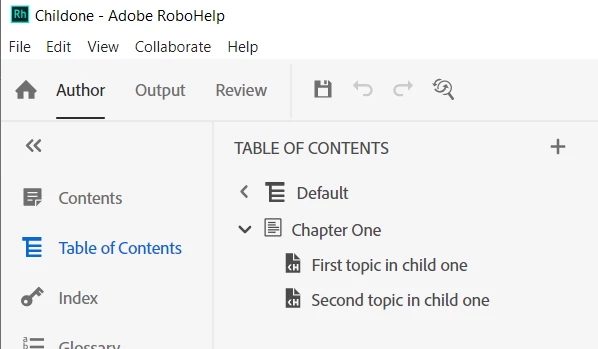

    ...where Childone then looks like this:

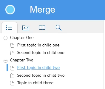

    ...and thus combined I'm getting an output like this:

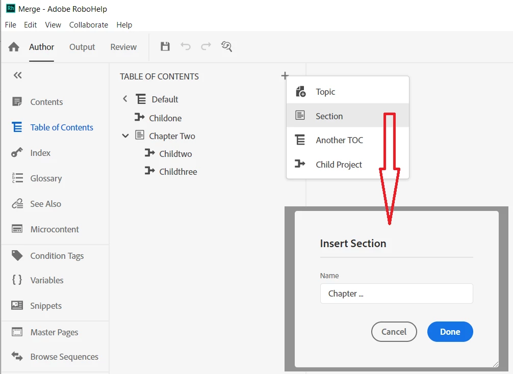

    I think you also want the parent TOC to have pages that are in fact in a child project. Is that correct and if so, how have you set up the link to the child project? No, I don't think this is needed... I'm just setting up *sections* in the parent, and it seems in Robohelp 2020 doesn't actually allow for these to link to a topic:
    (whereas in 2019 I would add a "book" which could indeed be linked to a topic too)

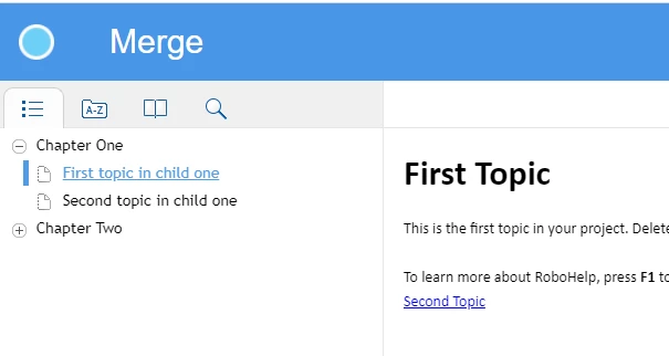

    Then in the parent output, the default topic is set to the child project, Childone.rhpj, which has it's own default topic... thus when opened initially, my output is looking something like the below (which is fine -  I have no issue with the books in the TOC being open/closed initially)
    So all-in-all, I'm quite happy that currently the setup is how I wanted. I didn't expect complete reassurance that this somewhat complex structure wouldn't potentially lead to some issues... was more interested in if anyone was going to chime in with an immediate "woah, definitely don't do that as you'll cause the world to end!" Or perhaps a more realistic issue with our user manual that would amount to the same thing, from my PoV 😉
