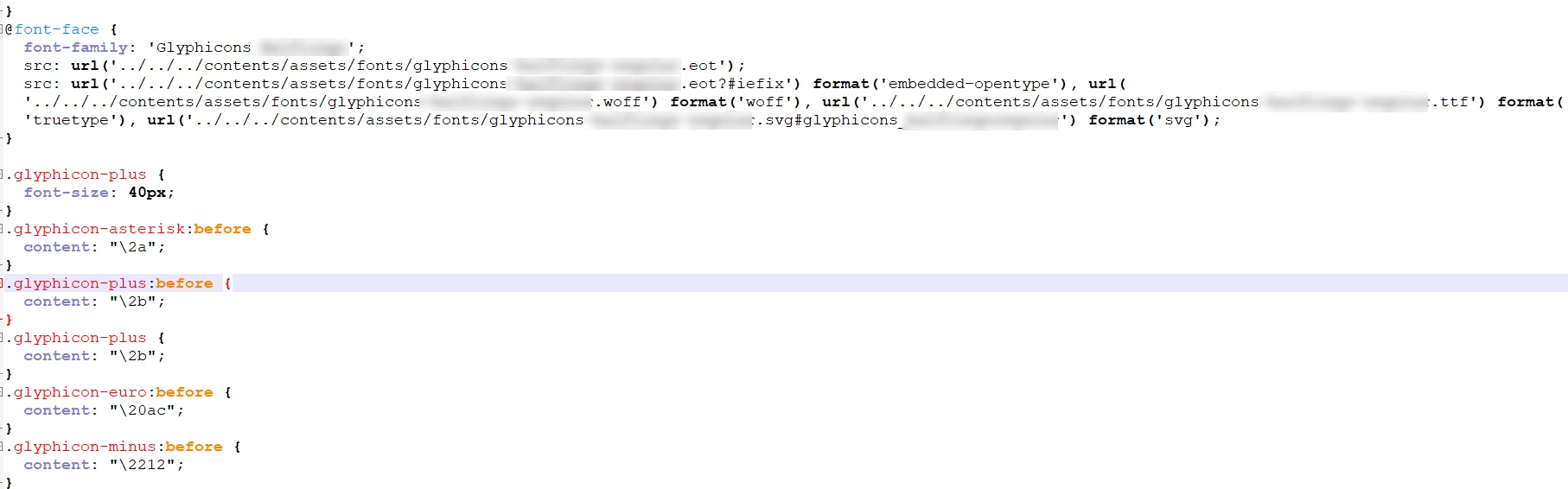

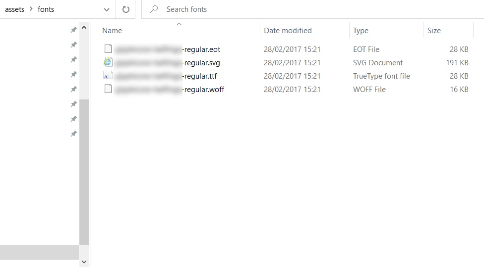

We use custom fonts in the company to make use of a plethora of icons.
These fonts are imported in the CSS files:
... and used when writing instructions:
The problem

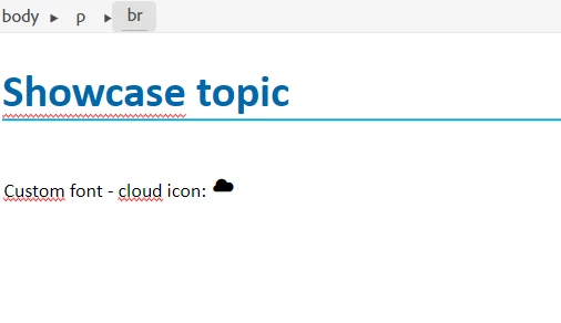

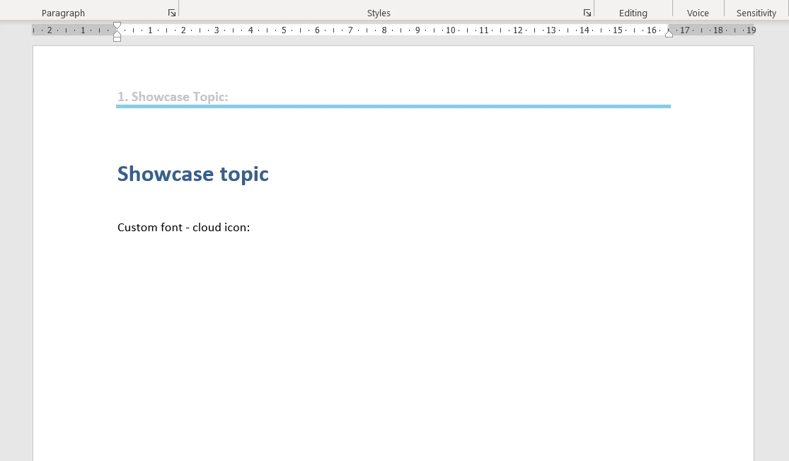

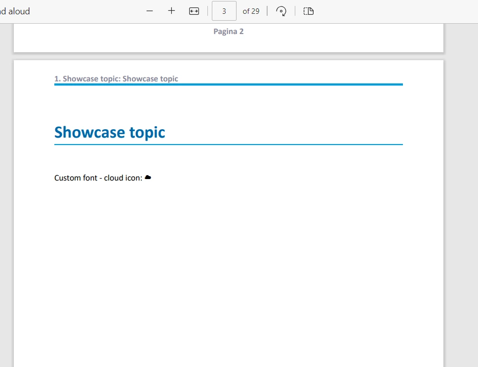

Publishing this topic with a Frameless output preset or a PDF output preset successfully shows this custom font icon. However, the Word output preset does not. Is there a way to make custom fonts work for Word outputs?
(PDF)
(Word)

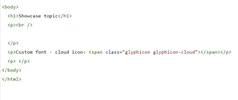

    Sep 5, 2023 9:12 AM UTC
    I've been leaning to method 2 (post-processing in the Word doc).
    Unfortunately, the resulting Word document does not contain any trace of the glyphicon (in HTML, it's after all just an 'empty' <span class="glyphicon-X">/span> element and I can't seem to assign a Word style to nothing). So I first have to add in the glyphicon classes as text in the span element in Robohelp with a script, generate the Word doc (and discard the changes afterwards with Git).
    Then I can use search + replace to replace all instances of the glyphicon text with the glyphicon itself. I guess this workaround is acceptable since we'll only publish to Word once in a blue moon.

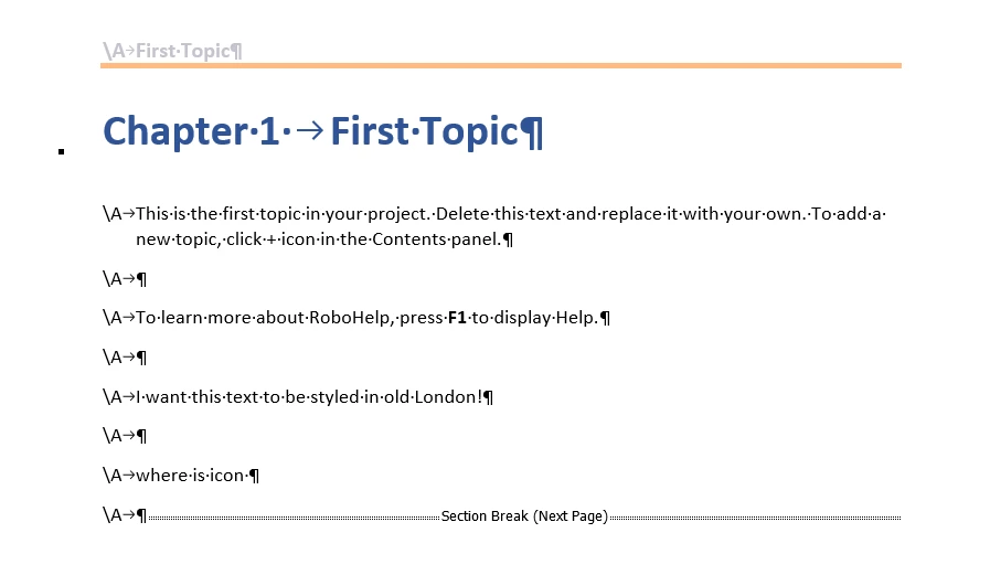

    Sep 4, 2023 12:23 PM UTC

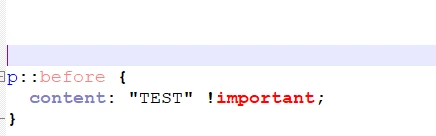

    My current hypothesis is that Word output is not very happy with the CSS content attribute in a pseudo class.
    If I force the following CSS:
    The Word output looks as follows:

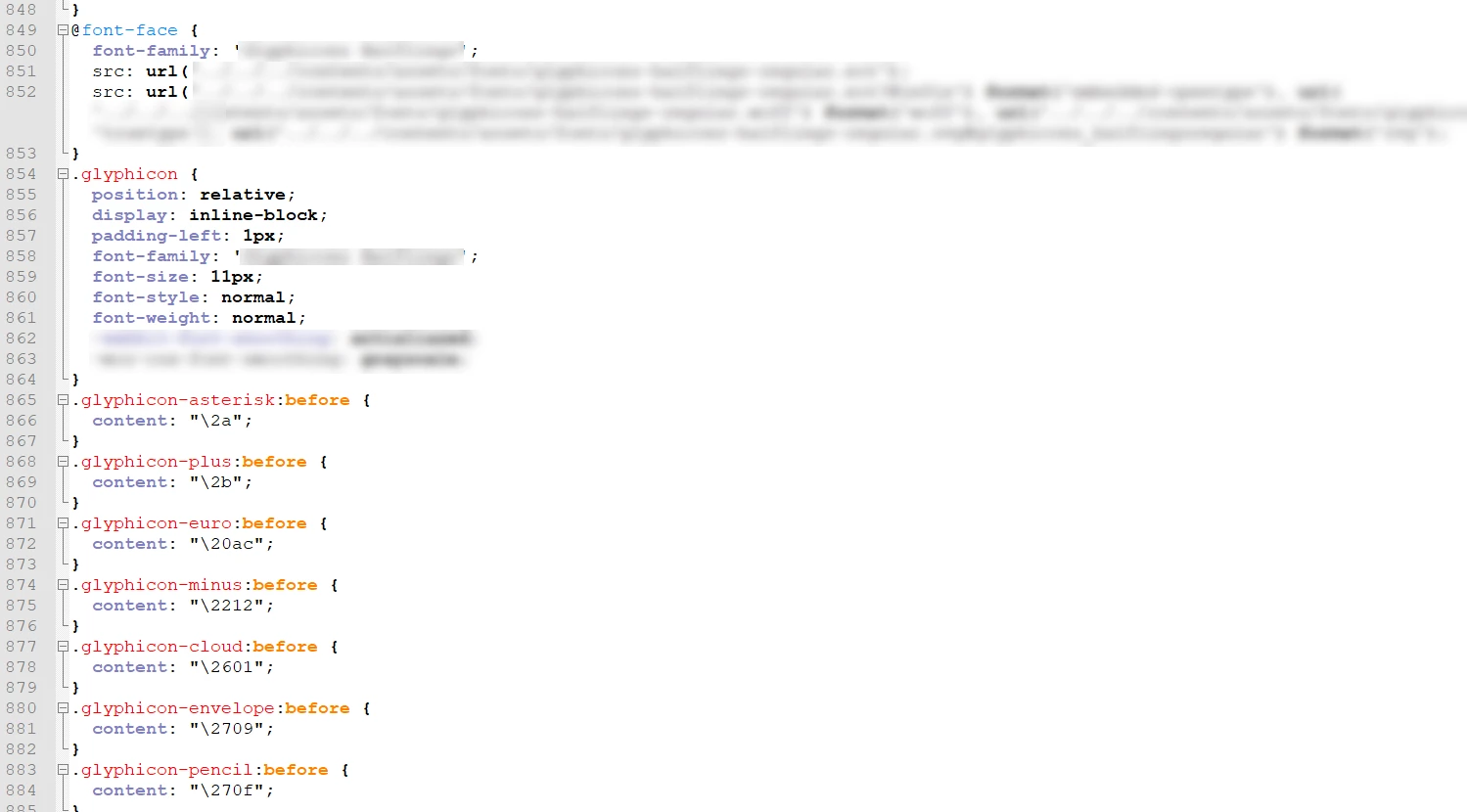

    I can confirm that the font shows up in Control Panel\Appearance and Personalization\Fonts. It also shows up in Word:
    Another possible cause is that I might have botched the layout.css for the Word preset:
