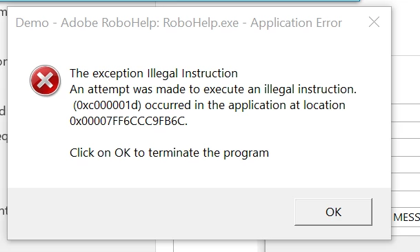

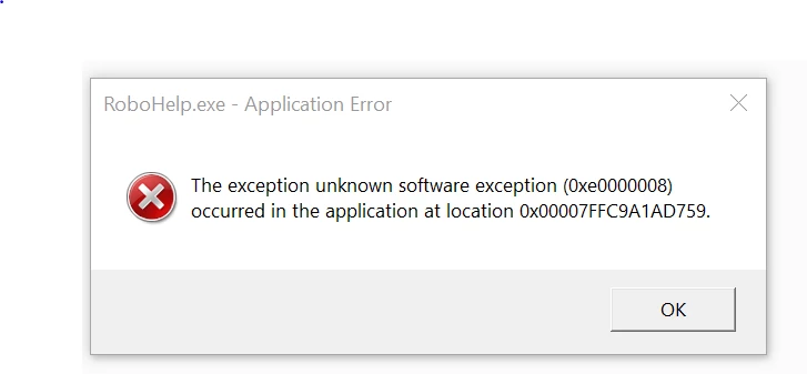

    I was able to transition from the Trial version to the full versoin and tried to generate the Responsive HTML 5 output and received the following errors.
    I'm now trying to figure out what this error message means and how to fix it.  Any suggestions on where to find additional details on these error messages and how to correct them.
