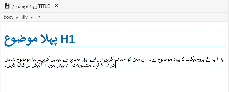

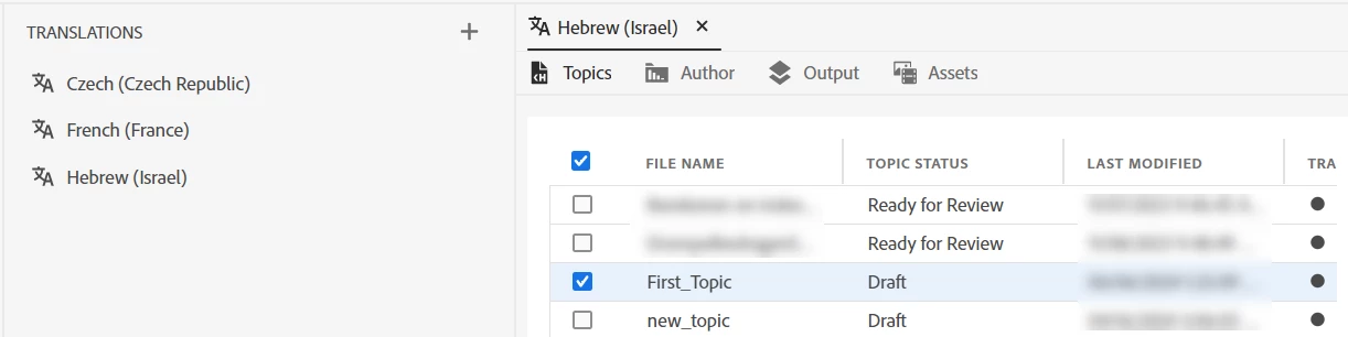

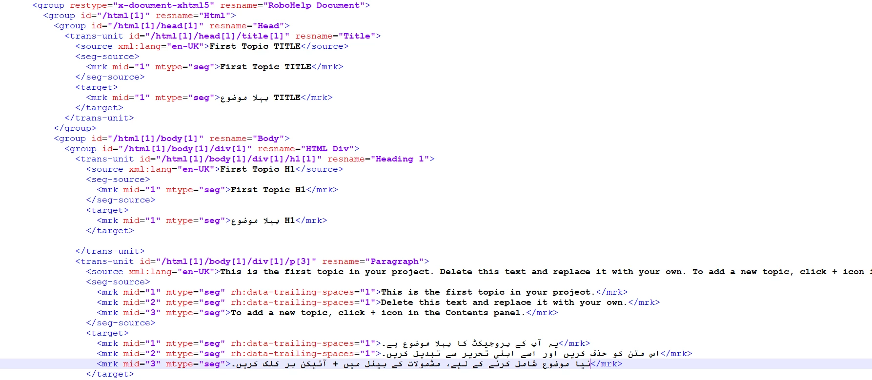

    To question 2:
    Interesting question, especially as those languages have a different writing direction.
    We can quickly test this:
    1) export the XLIFF in a random supported language pair (Hebrew)
    2) 'Translate' the XLIFF in Urdu, ignoring the language code
    Note that you may have to manually change the language code in the XLIFFs for the translation provider to be able to translate in that language.
    3) Import it back
    I'm not sure if the direction is respected (I doubt it), but the content works at least:
