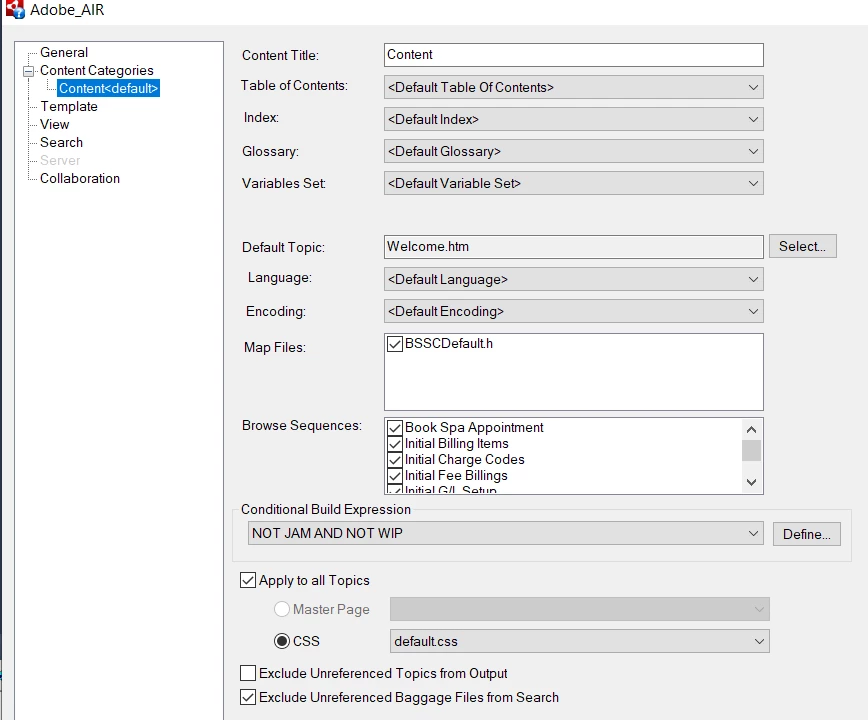

    An SSL is only a recipe of what is going to be put in the output - it's not the same as a Table of Contents - your SSL uses a TOC to determine what appears in the output. Here's an example from a RH11 project of mine:
    It just uses the default TOC that the project creates.
    Maybe you can show us what you mean in your SSL in RH2017. Use the image icon in the web interface to stick an image in your post.
