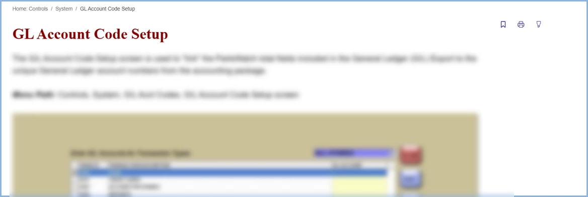

Problem With Framless' "In This Topic" Section on ONE Topic
Normally, the "In This Topic" section of the Frameless output has links to the H1, H2, H3, and H4 styles, and links to them as such, without using bookmarks. See an example of the filepath/webpage URL that pops up for a normal topic when clicked in the "In This Topic" section.
Now, see below an example of the page that is failing. I believe it is throwing Error 403 Forbiddens to our customers because it is using bookmarks (and incomplete ones, at that) to try and call the section of the page.
How do I fix this?

    The issue I saw was In This Topic did not show anything as you can see in the image in the post at https://community.adobe.com/t5/robohelp-discussions/problem-with-framless-quot-in-this-topic-quot-section-on-one-topic/m-p/15389372#M157674
    To correct that I showed the problem with the code. The topic has no headings, as you acknowledged. If you fix the code for what should be headings, they then appear and work.

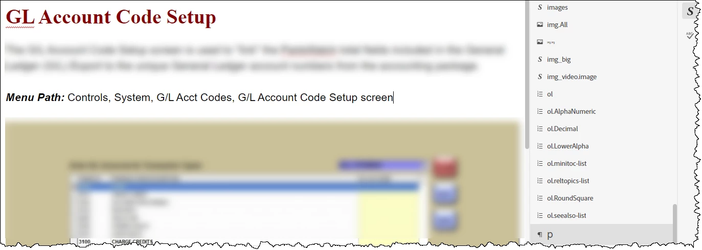

    If I do that in Parts Watch H2 applies to the whole line so used Enter after Menu Path so that the rest is on another line and I applied P to that.
    Next I have worked through that should be a heading and made the same changes. So that the above appears as
    Having done that, I generated an output using your Frameless preset and this is what I see locally.
    All links work without error. Please explain what I am not understanding about this part of the issue.

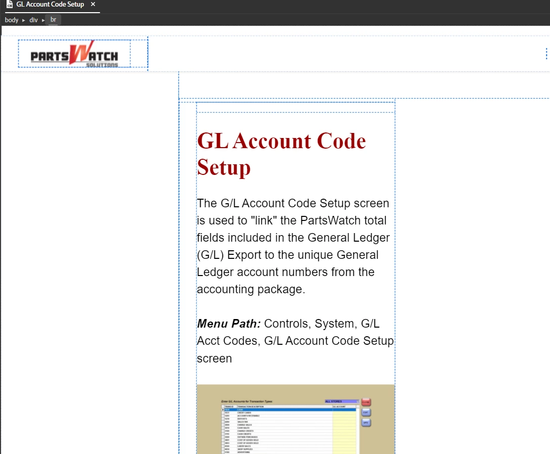

    I can't even open my test file anymore, it says it didn't load properly this time. The import of the topic is all jacked up, are you able to open the other Project? Same file is in there to inspect.
    Jun 25, 2025 6:37 PM UTC
    The import obviously is failing, because the author view and output of this file is totally wrong in the test file.
    Look at this:
