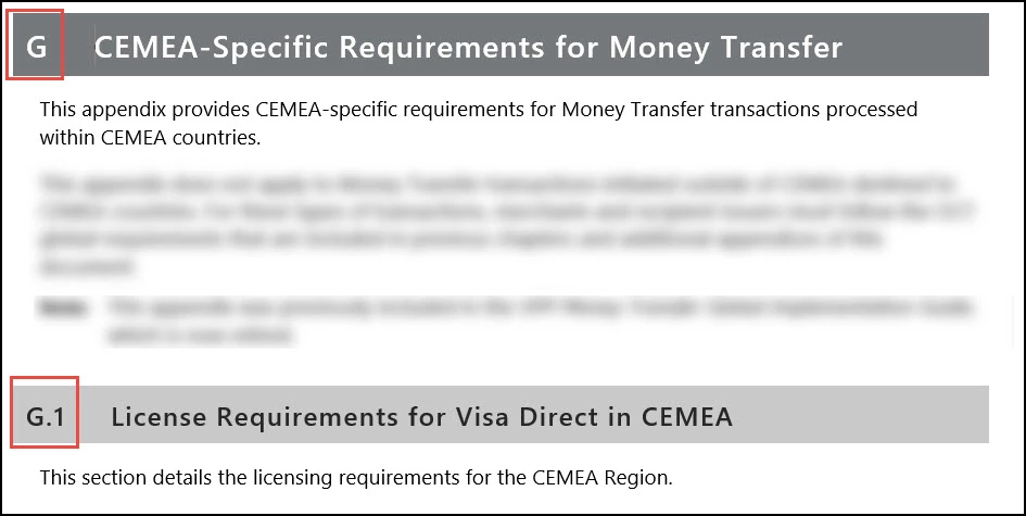

Jan 28, 2020 6:11 PM UTC
Hi Peter,
I had the same question as Erwin wrt Chapter and Section numbering. You mentioned in this thread you had a sample project attached. I don't see the sample project in this thread. Can you please resend the attachment. Here is a screenshot of what I'm trying to achieve. I am able to get Heading Level 1. but in Heading level 2, I'm seeing either 1.1 or A.A etc. How do I get a heading level A.1?
Jan 28, 2020 6:14 PM UTC
For some reason my screenshot failed to appear in my post. Attaching it here once again.
