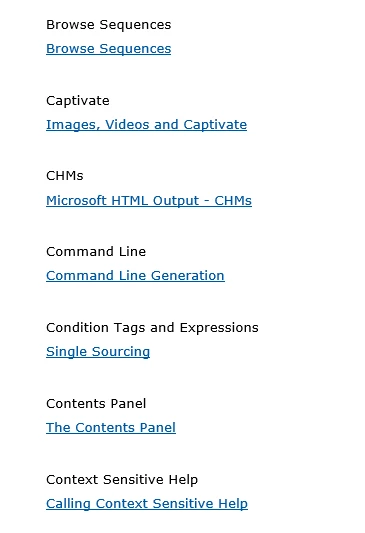

    The index bit is showing the index keyword followed by a link to the topic(s) associated with the keyword.
    Viewed online that works. Where it falls flat is in a printed document as there is no page number.

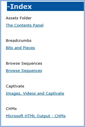

    May 5, 2020 1:26 AM UTC
    Yeah that's not a word index. That's just the html format link list pasted into a Word document.
    I personally would report it as I wouldn't considered it acceptable in a Word or PDF output, and the only work around is to manually re-create every index entry in the output so that a proper index can be generated.

    The index from the RoboHelp_Reimagined example is also not in the format I'd expect - this is the same as I'm getting for my own project.
    Do we know if this is something that's to follow, or a bug I should report?

    Actually new question about indexing. In the old output the Index was just that; a list of headers (I think, maybe keywords of some sort) in alphabetical order with page numbers. If I include an Index in the new UI edition, I just get a list of topics, and another separate hyperlink entry of the same topic wording. Is that something else that's not done in the new UI yet, or a setting I'm missing?
