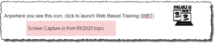

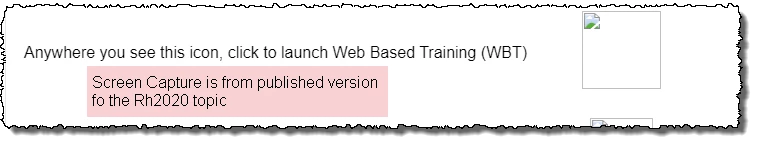

I am using Rh2020.4.173.  I have images loaded onto a topic.  Their extention is .png and the appear fine.  I also have a hyperlink associated to them.
When I create an output and publish the page, I am not seeing the images.

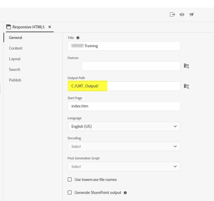

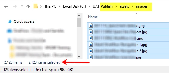

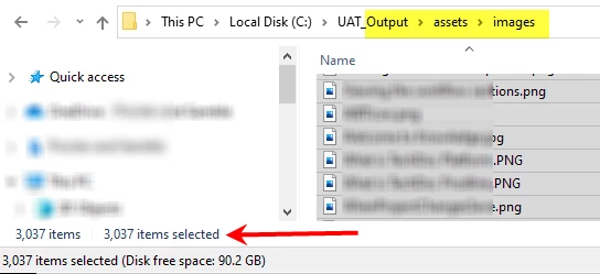

    @Peter Grainge - I am not copying anything to a server at this point.  I am writing all files to my local hard drive.  I only copy to a server after I know everything is correct.
    Here are the images of my Output assets > images and Publish assets > images folders.  Please pay attention to the highlight and where the arrow is pointing in each image.  These are both located on my C:/

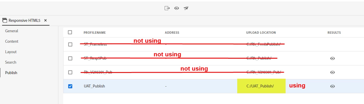

    Publishing locally is an option but are you using File System?
    If you are, have you tried just changing the target folder?

    Apr 26, 2021 3:33 PM UTC
    Yes I am publishing to a File System.  Sorry for not being specific in my answer above. 🙂
