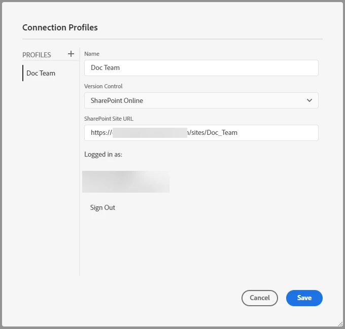

    Question: Do we need to have to a separate folder for each robohelp projects? In other words if this is my sharepoint url:
    Should I have only one RH project in the doc_team folder? And for each rh project I would have a new connection profile pointing a different folder?
