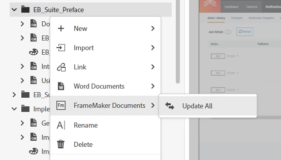

The project is now in Robohelp. However, when I went to edit a topic, I did not get a message to say that it is not checked out. If I right-click the topic, check out is not listed as an option and if I select Collaborate > Check in, the file I have edited is not showing up as needing to be checked in.
Its like Robohelp does not think there is any version control on this topic. So far, this has happened on about 4 topics. However, its not happening on all of them. I have now selected collaborate > Get latest version to try and get these files from sharepoint. I have checked the folder in sharepoint and they are there and my colleague has worked on them and checked them back in (last week) with no problems.
