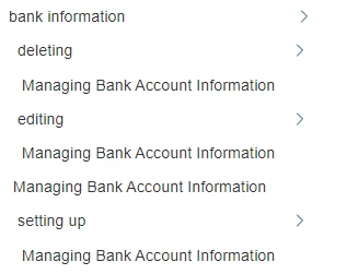

2) I am generating Frameless output with a Studio skin. The index works correctly as long as the entry is just a keyword: I click the keyword, I go to the topic. If there's a subkeyword, the results aren't the same as they used to be: I click the keyword, it expands to show subkeywords, I click a subkeyword, and that expands again to show the topic title. I have to click the topic title to display the content. (The attached screen shot shows a very basic example, but I hope it illustrates the problem well enough---each subkeyword is supposed to jump to a bookmark in the same topic, and the keyword should jump to the top of that topic; you should not see the topic name at all.) At least this is is how it used to work. Has anyone seen this behavior after an upgrade?

    2. I think Jeff is referring to the index cross reference functionality. I believe in chm (and webhelp, from memory), that function jumped you to the cross referenced keyword (Merchant Category Code in your example). However, in Frameless all the topics from the cross referenced item are added to the other keyword. So everything under Merchant Category Code would appear under MCC as well.
    (I think Responsive might still have the old functionality where if the keyword or subkeyword only had one topic associated, it would jump straight to the topic without displaying the file name. )

    1. You could try using a semi-colon instead. It looks like comma is now a quick way to specify multiple keywords (which makes some sense, as they are now stored as a comma-separated list in the topic head tag, so it would be harder to tell what is a plain text comma and what is a keyword separator.).
    2. Yep, that's just how Frameless works. And you can't give a nice display name to the bookmark entry like you can in Classic - you just have to live with the filename plus bookmark text (e.g. mytopic.htm#mybookmark). HTML5 output still seems to work the old way (if the subkeyword links to only a single entry, clicking the subkeyword takes you straight to the topic). If you want that in Frameless you'd need to submit a feature request. You can request features and report issues here: https://tracker.adobe.com/
