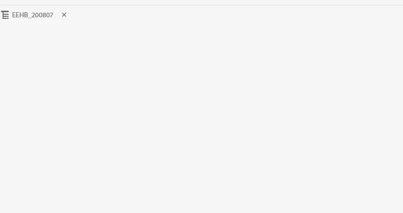

    PPPS:  One last clue for you. I created each of these problematic topics via the "New page" button.
    Is that the problem?
    These pages do behave strangely in the authoring pane: if I double-click one of them, no topic opens in the authoring pane, just a blank area. It looks like this:

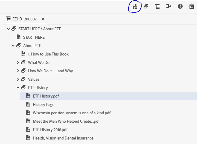

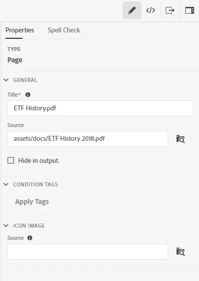

    Thanks for the troubleshooting, Amber. You've led me to the source of the problem.
    I had our SharePoint admin look at it. She shared this:
    "The URL to the pdf is incorrect which is why it returns an error. The URL ends with an extension of "aspx" rather than 'pdf'. This URL would have to end in 'pdf' for the PDF to be displayed. If you simply replace the 'aspx' at the end with 'pdf' it works. Does RoboHelp generate this URL for you? If so, the issue would be with RoboHelp not generating the correct URL. "
    So I'm thinking the problem is the way I've configured these topics. Whatever I've done is causing RoboHelp to generate the .aspx file extension instead of .pdf .   I've set them all up the same way, like this one:
    Can you tell me how to do it properly?
    Thank you!
