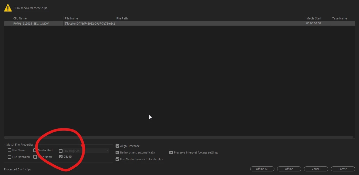

As a workaround for relinking, I have found, that choosing only clip ID, I can select multiple offline files with the locatorID-issue, and then I only need to find one filename match manually - after that, it automatically links the others. (as a sidenote I am doing this on CC2019 on a windows 10 machine).
I hope you guys find a way!
PeterELee
Adobe Employee
Adobe Employee
Jan 3, 2019 8:01 PM UTC
Great find! We're still working on a fix for the underlying problem, but we've just tested your workaround in-house and confirmed that it works for most files that we tested. When only "Clip ID" is checked under "Matching Properties," the Locate code will search the XMP metadata of your media files, looking for one with the same Dublin Core "identifier" field as the clip had when the project file was last updated.

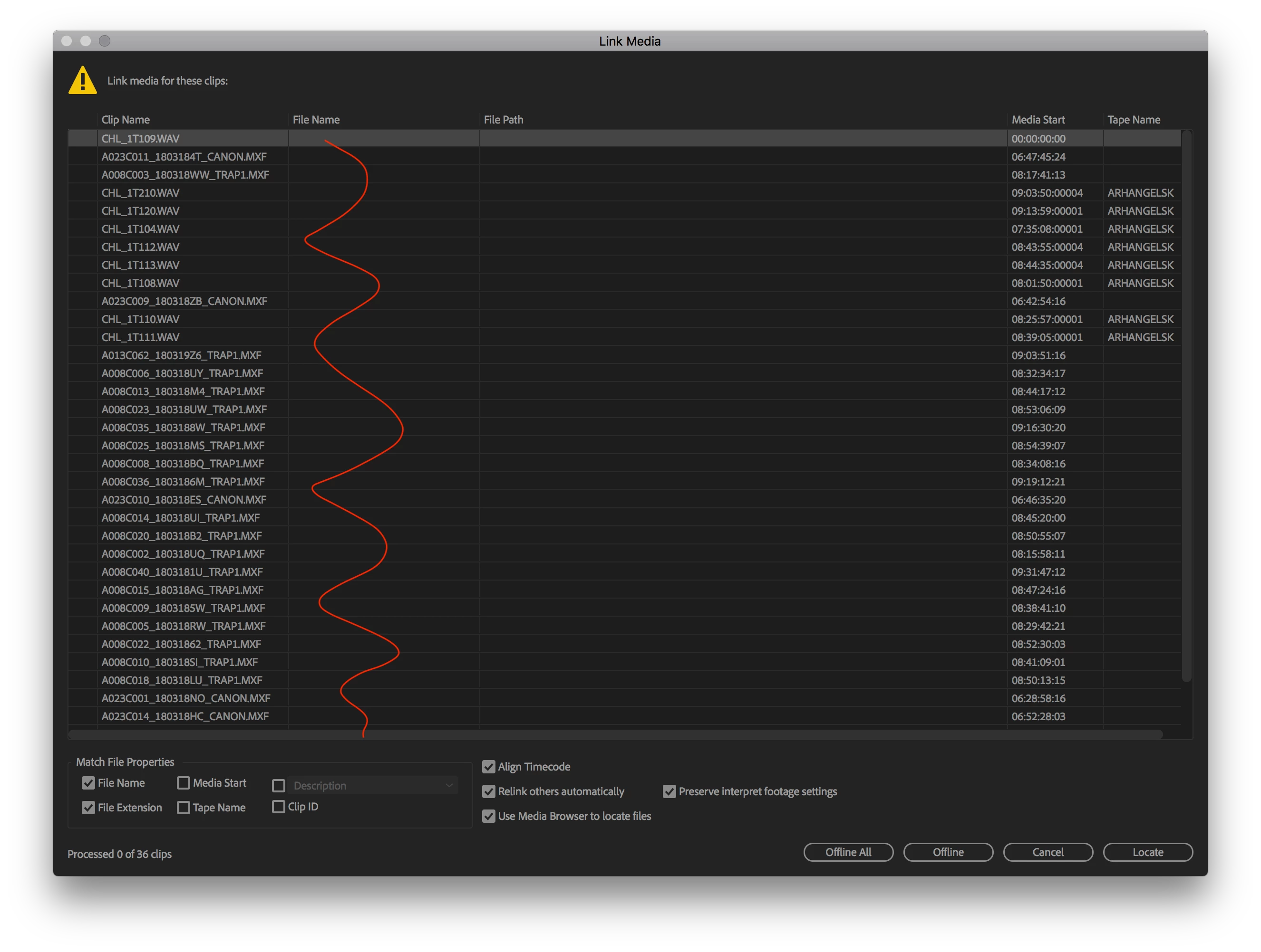

Jul 17, 2018 3:16 PM UTC
I'm sorry for all of the issues you've been encountering. The issue shown in your screenshot, with the strange file paths, should be fixed in Premiere 12.1.2, released last night. I don't believe the fix will help media that was relinked using the "Link Media" dialog in a Team Project, but it should apply to any media that was simply imported, or moved using the Team Projects "Media Management" dialog.
"Link Media" doesn't really work in Team Projects, and the menu item is normally disabled in a Team Project. To move files in a Team Project so that all of your collaborators can find them, too, please use the Media Management dialog, as described here: Add and manage media in a Team Project  Another bug in Premiere 12.1.1 caused certain h.264 media to be incorrectly listed as off-line, or to be listed as audio-only instead of A/V. This bug caused additional problems in Team Projects, and may be related to why the "Link Media" dialog was shown in a Team Project. The h.264 bug should also be fixed in 12.1.2.

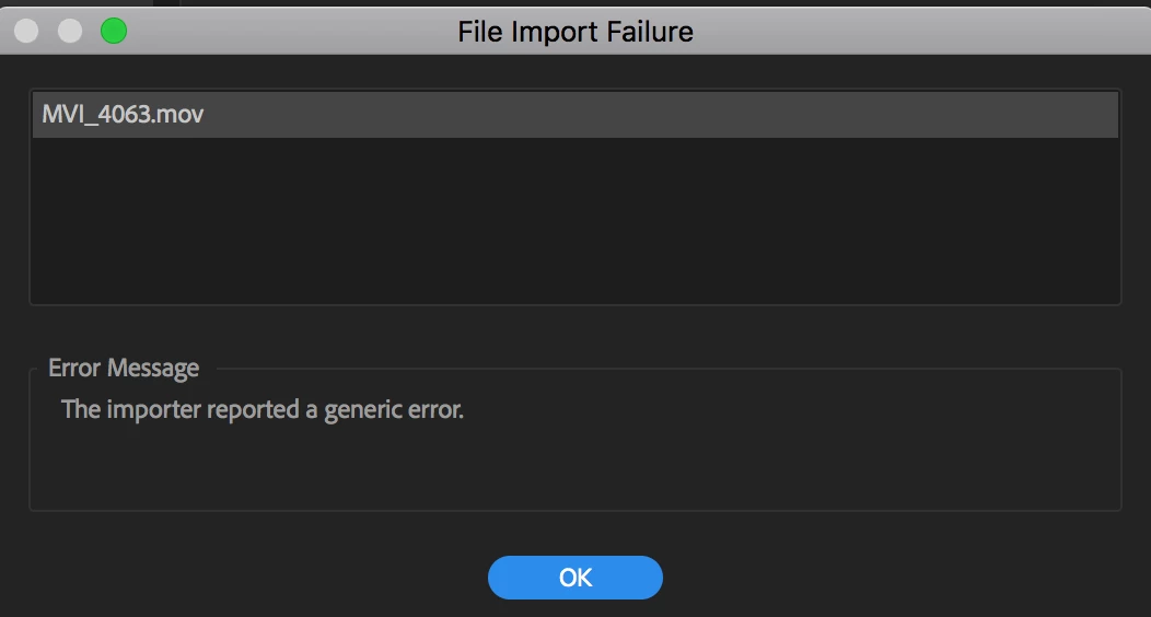

I just tried that, converting to team, then re-inking via search and am now getting this error message
HunterH_HM
Jul 6, 2018 5:17 PM UTC
That might be unrelated, is that for every clip or just the one? Also are your clips now showing online or they still show the Locator ID error?
