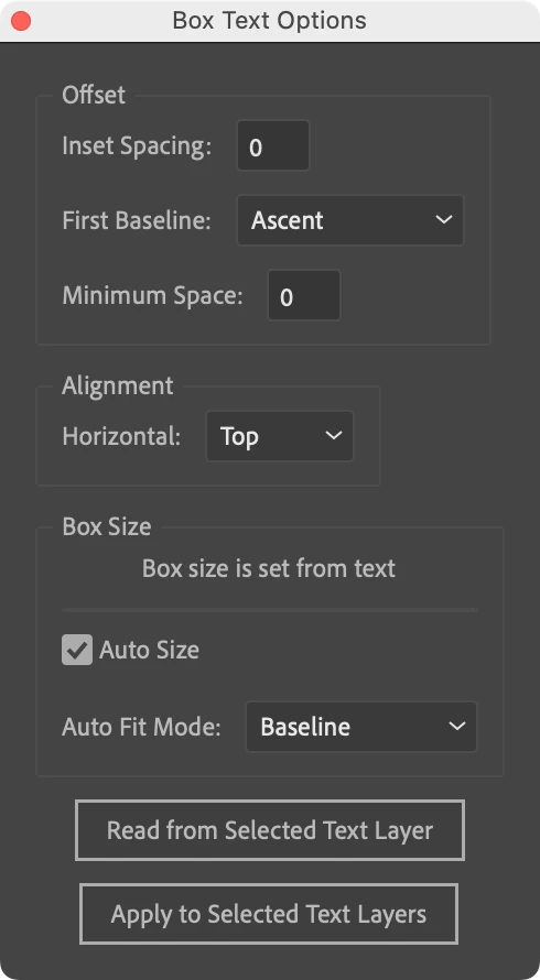

To try out these attributes without needing to write your own script, download and run the attached sample .jsx scriptUI panel* and run it from File > Scripts > Run Script File... You should see a panel that allows you to try out these attributes on your own Text layers. You can also view and download the script at https://github.com/AdobeDocs/after-effects/blob/main/samples/ComposeBoxTextOptions_ScriptUISample.jsx.
*The attached file has the extension .jsx.txt because the forums do not support .jsx attachments. You will need to remove the .txt extension to run the script in AE, or download the .jsx directly from the GitHub link.
