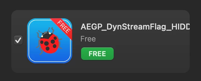

- Once the download is complete, unzip the file and double-click it to have the "AEGP_DynStreamFlag_HIDDEN" plugin be ready for testing in After Effects. The product will be visible in FxFactory as such:

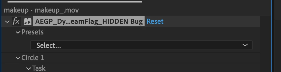

- Open an exising Comp, and apply the "AEGP_DynStreamFlag_HIDDEN Bug" plugin found under the "AEGP_DynStreamFlag_HIDDEN" category:

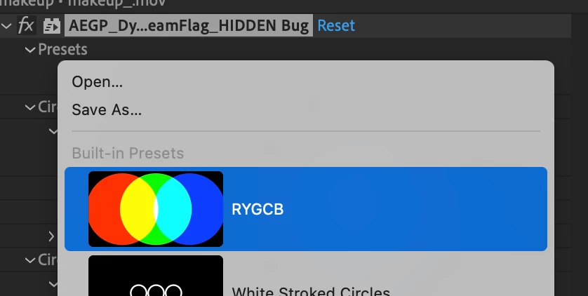

- Notice that the plugin has its own Presets parameter:

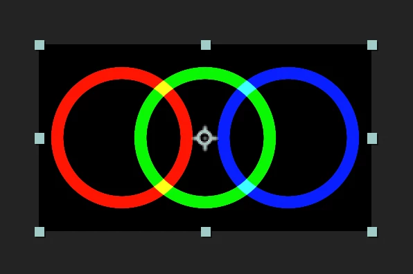

- Each of the two built-in presets has a Thumbnail. That thumbnail shows you what you’re supposed to see once all parameter values in the preset have been applied. Select the first preset, which should cause all three circles to become filled (rather than stroked) and the Add blend mode to be used:

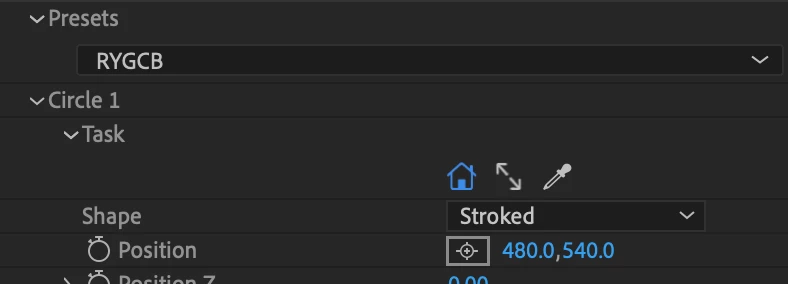

- As the plugin applies the preset, notice that After Effects has only allowed certain parameter value changes to occur. The blend mode has been changed to Add, but the circles are still Stroked:
Why did After Effects ignore some of the changes? After the RYGCB preset is applied, the Shape is still Stroked:
- The bug is therefore as follows: the plugin has set the parameter value for *all* parameters in the preset, making sure to set the PF_ChangeFlag_CHANGED_VALUE flag, but After Effects simply ignores any such changes if the parameter in question happened to be hidden, i.e. if the parameter had its AEGP_DynStreamFlag_HIDDEN flag set to true.

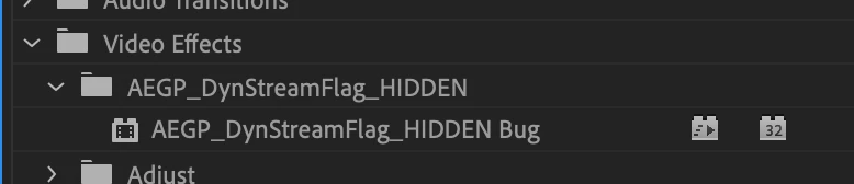

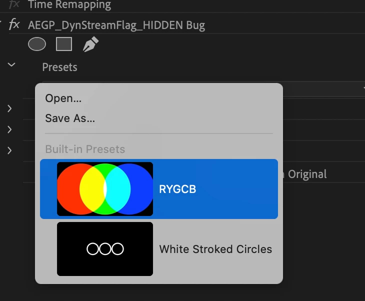

For comparison, you can try the same exact plugin running in Premiere Pro:
- Locate the same effect:

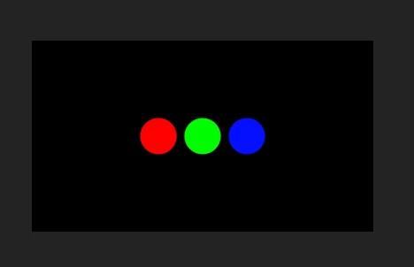

- Apply it to a clip and select the same preset:
- Notice that in Premiere, all three circles are correctly set to Filled, and the Add blend mode is used.
