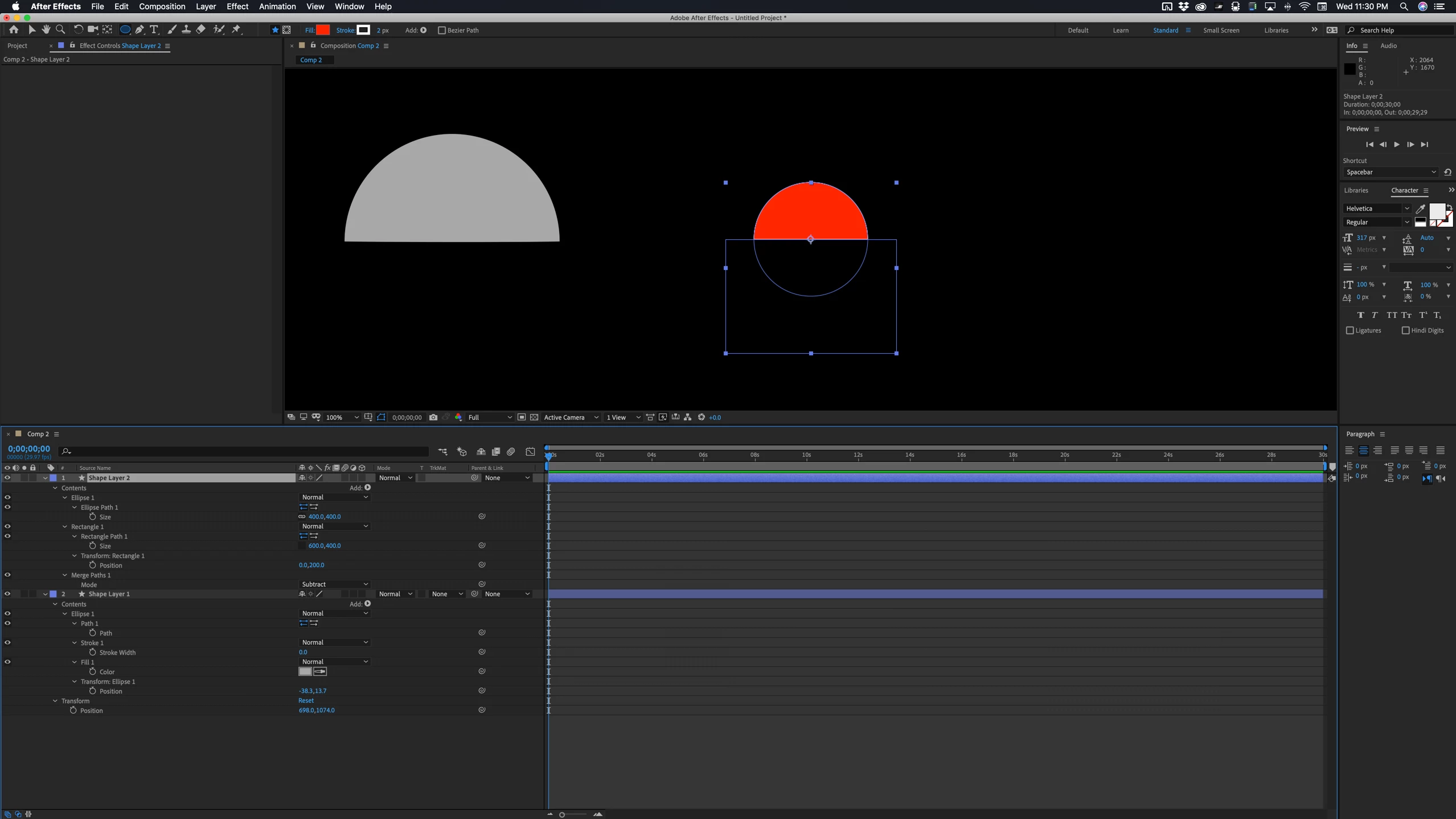

    Here's a screenshot that shows both methods with the modified properties of both shape layers revealed.
