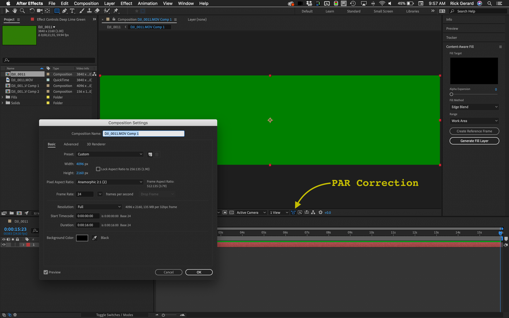

You are working twice the width and modifying the pixel aspect ratio to 2:1 so it is normal. Press the button Toggle Pixel Aspect Ratio Correction and see what happens.
Byron.

Your frame size is CINEMA DCP 4k Square Pixels so at least part of your comp is set up correctly for rendering a production master but the frame size does not match YouTube or any other streaming service frame size. The Anamorphic 2:1 pixel aspect ratio and frame size do not match any standard I know of.
If you are absolutely sure that is the size and pixel aspect ratio you must use for your final render then you can do one of two things. Fix the preview problem by turning on Pixel Aspect Ratio correction in your composition panel and end up with a display that looks like this:
Or you can double the width of the comp and change to square pixels, then, after you have completed your work, drop the final comp in an Anamorphic comp for rendering. It will automatically resize to fit.
The odds of that frame size and pixel aspect ratio giving you content you can distribute to anything the public can see without distortion are extremely small. I'm also concerned that you have interpreted all the footage going into the comp as 2:1. If the footage did not come from a camera using an 2:1 anamorphic lens then changing the interpretation just fouled up your footage. You never force the footage into a pixel aspect ratio that does not match the original footage. You only change the pixel aspect ratio of footage if you know for sure that After Effects misinterpreted the footage. This could happen if you rented an anamorphic lens and put it on your DSLR and shot some footage. If the footage was not shot with an anamorphic lens, then you have fouled it up.
