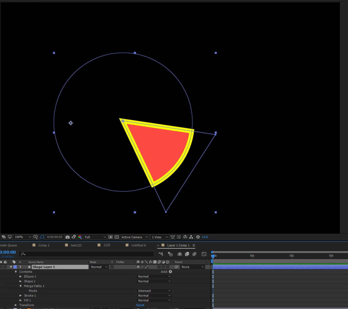

you can:
1. instead of using a mask, use another shape as the mask and use a merge path operation with intersect

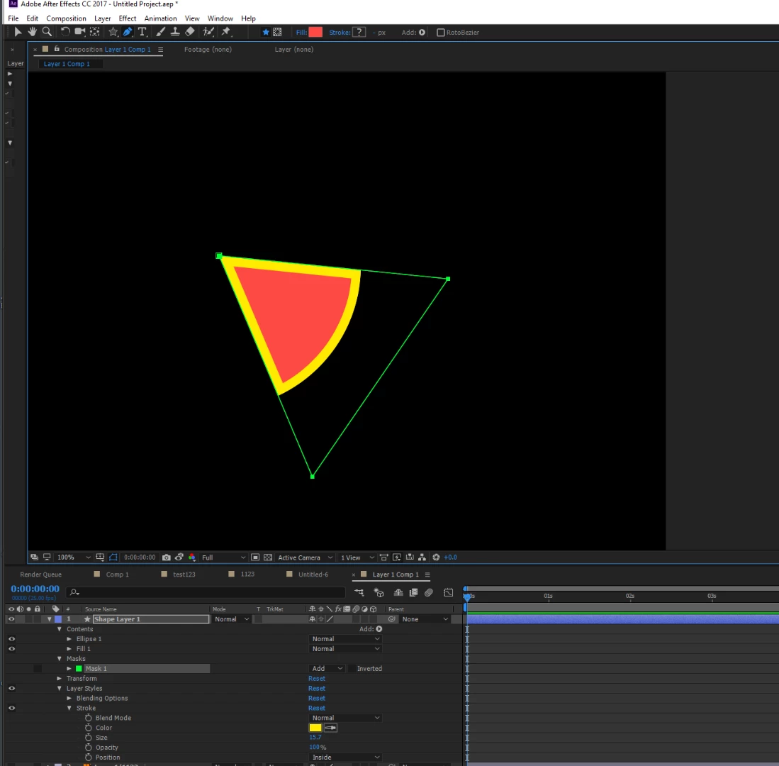

or
2. keep the mask, lose the shape stroke and use a layer style stroke by right clicking on the layer->layer styles->stroke
