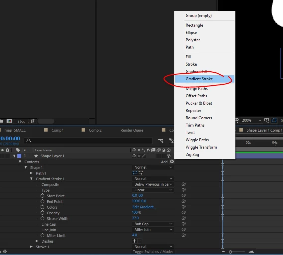

Not layer style. Toggle the shape layer hierarchy and you will see an add button where you could add a gradient stroke.
but if you plan to extrude the shape it's not supported for extruded shapes

Extruding text and shape layers in After Effects this guide says that gradients aren't supported on 3d layers. However, I wanted to fix it by adding two lights (spot) on my 3d object. One yellow light at the top left, and one blue light at the bottom right. However, I want my OMKT (white) part to stay white.
Does anyone know how to achieve this?

If you plan to extrude them then no, gradient stroke are not supported. as to the lights issue, you could separate the part you wish to be uneffected by the light and in its material options set accept lights to off.

Thanks! Turning the light off for that material worked. I'll post the link to my image in this thread when it's rendered.
