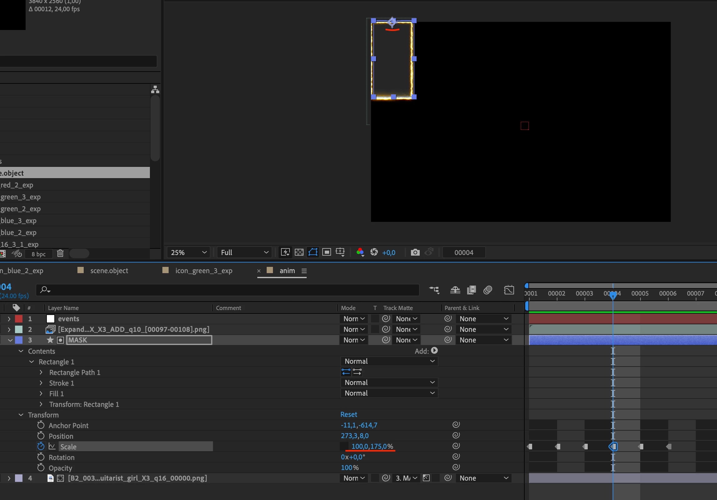

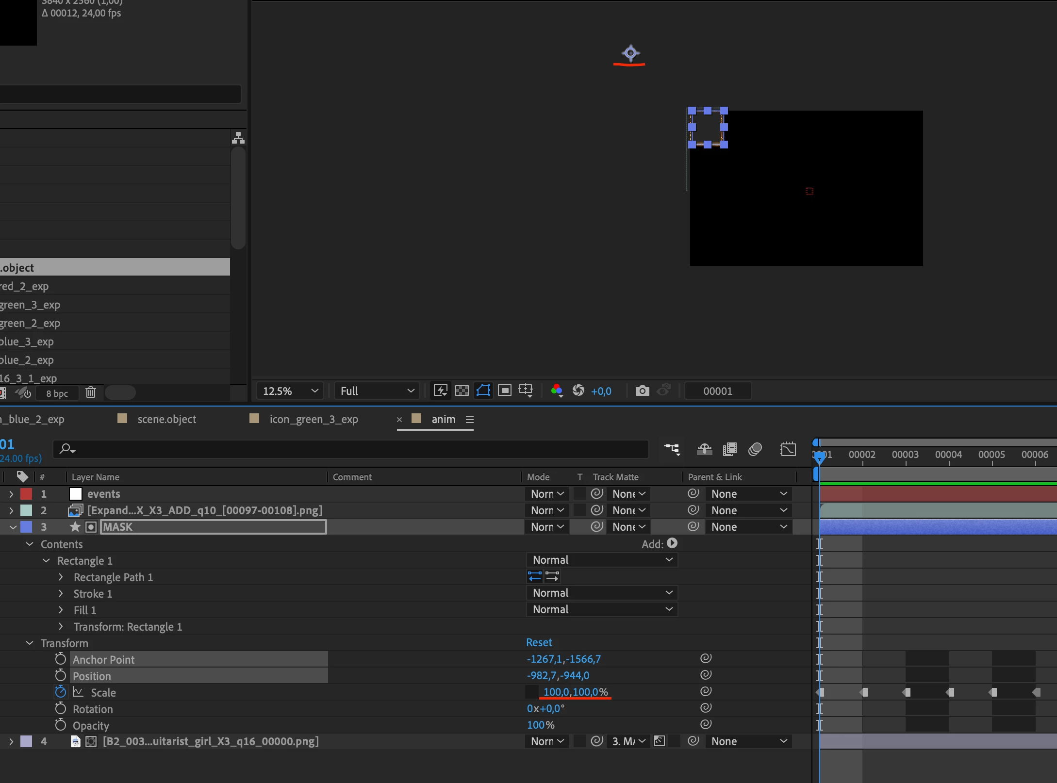

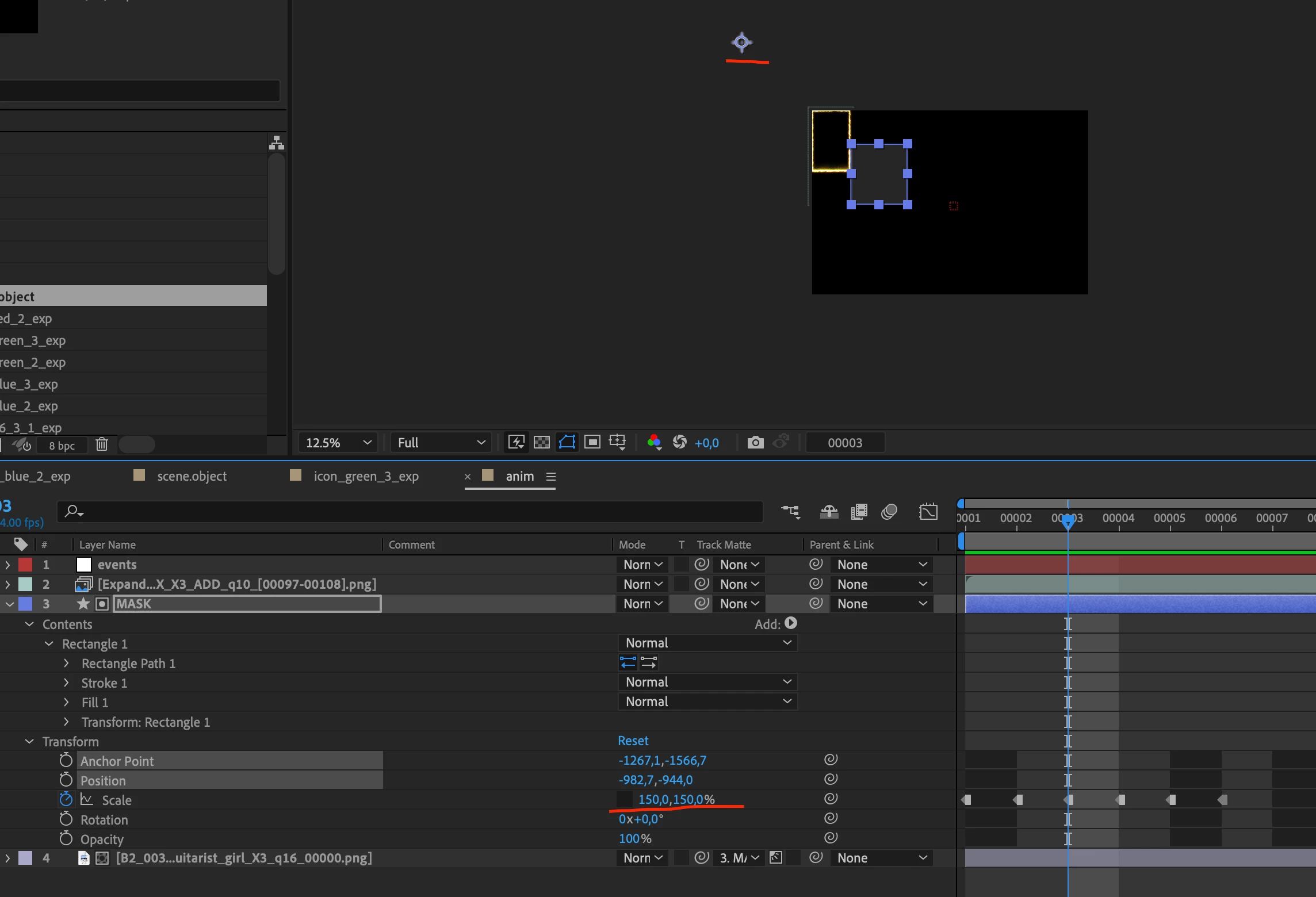

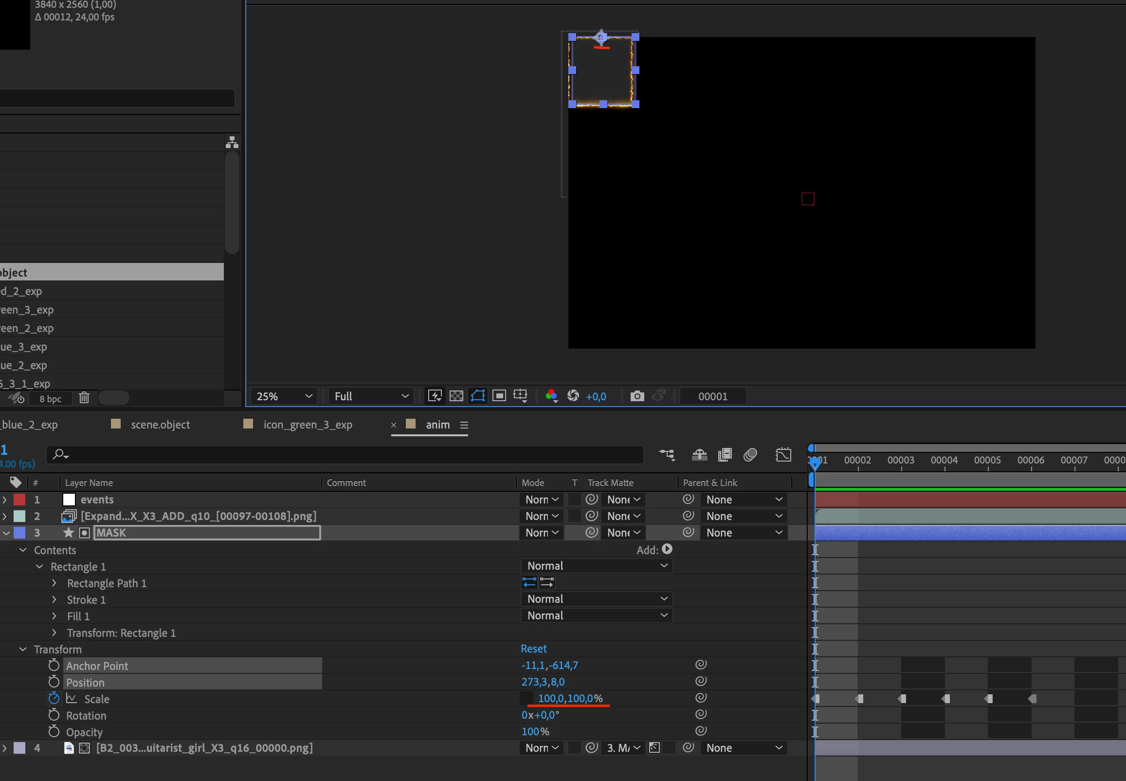

Hi, I need to calculate shape layer position, for example top left point A(x, y) for rectangle shape layer scale animation relative to anchor point. Is there any formula which describes point A movement? Base on data I am getting from AE I can get original position, but during animation only scale property changes.
I've attached few examples with different anchor point position.

That should get you started, but your screenshots make me think that you have applied a mask to a large shape layer and that you are using the Mask to generate a path using Video Copilot's Saber plugin. If you want to attach another layer to a mask position, you'll need to run a different set of expressions to calculate the size of the mask. A starting point for that kind of problem would be to use the Window/Create Nulls from Paths/Nulls Follow Points script tool and then throw a scale multiplier into that calculation.
