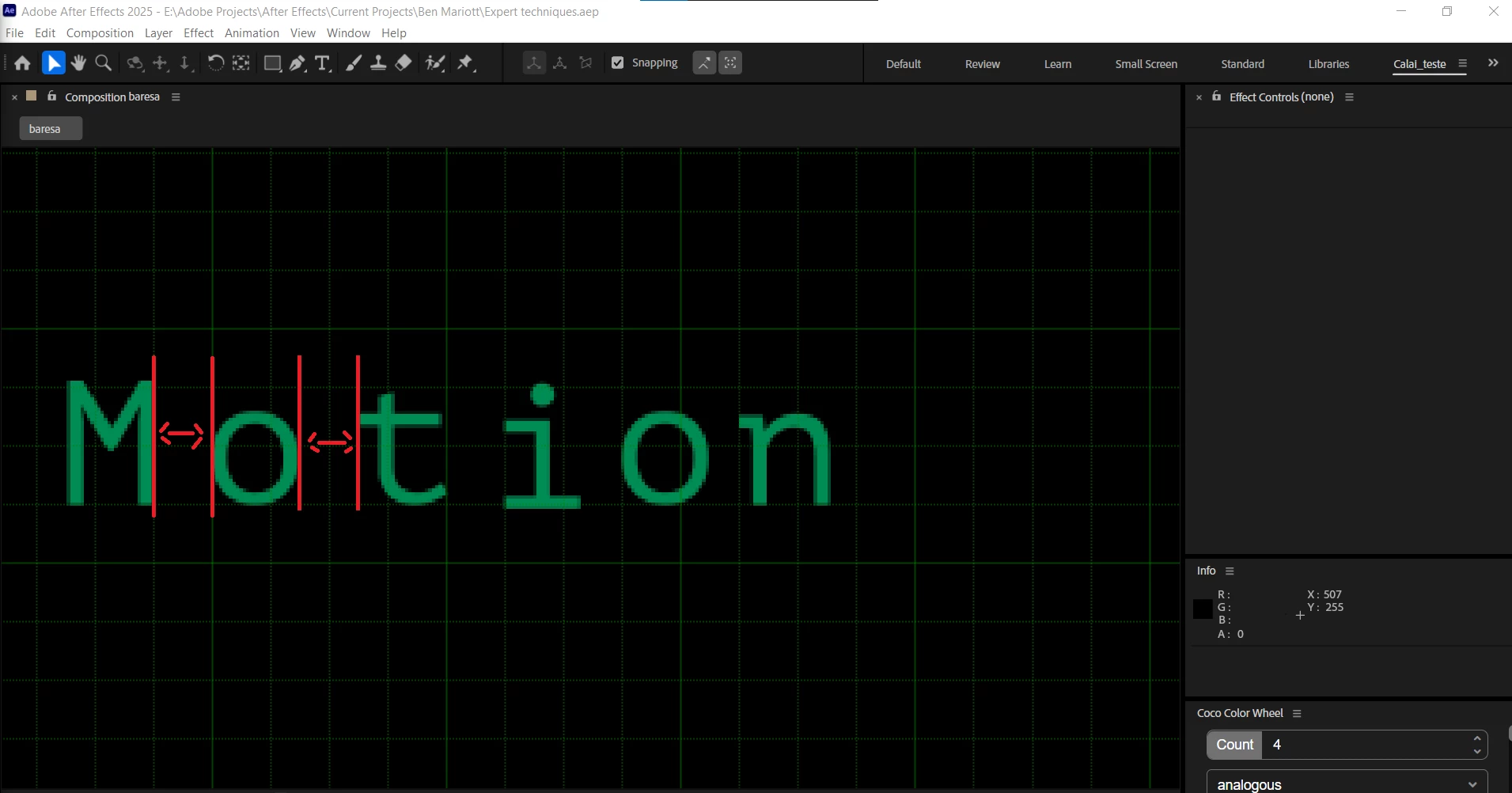

Have you tried enabling Snapping and then using a Solid as a spacer as you drag and drop the edges to each other?
If you use a monospace font (if that's an option design wise), that should provide consistent spacing between the characters.

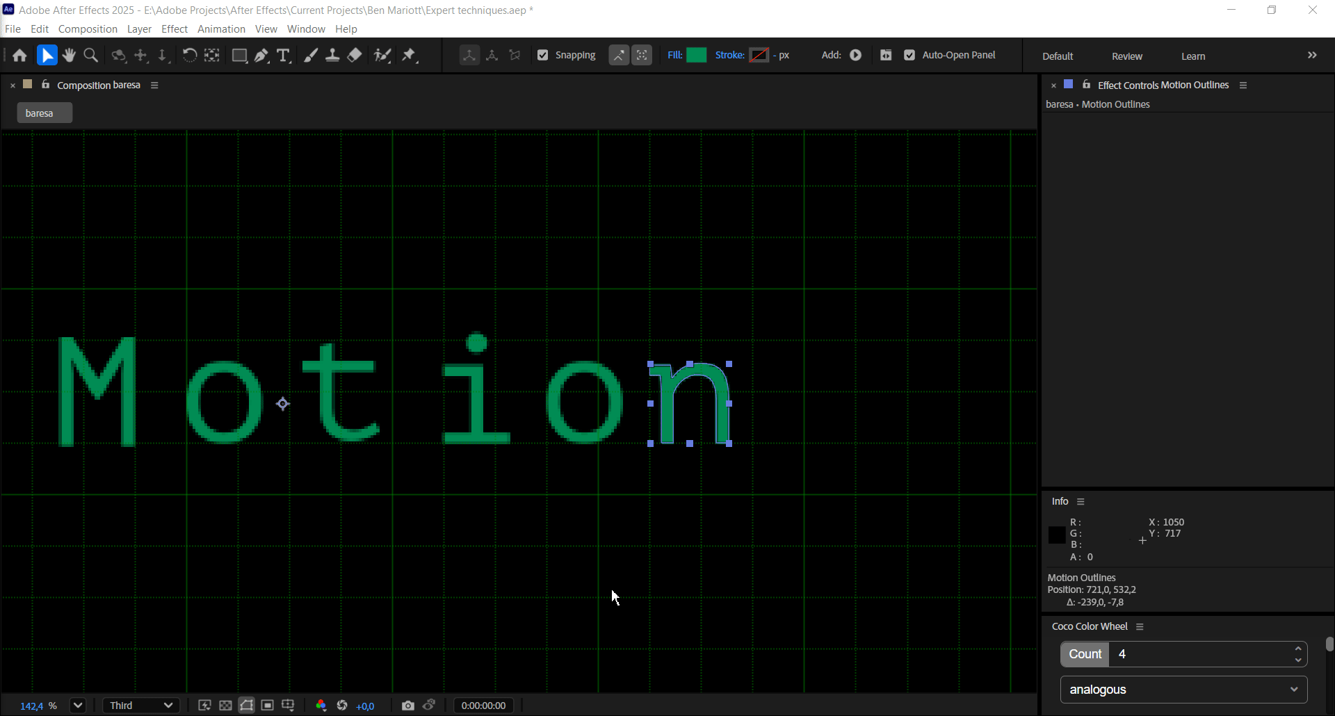

I am actually about to complete a set of 20+ scripts and one of it does allow for a fixed gap set between layers and they can be sized differently, are child layers and theit Anchor Point can also be anywhere you choose. Below is a screen capture showing its UI and how I set it up with different sizex text characters and Anchor Points and a Fixed Gap setting.
If you want to test it, drop me a DM and we can continue from there.
