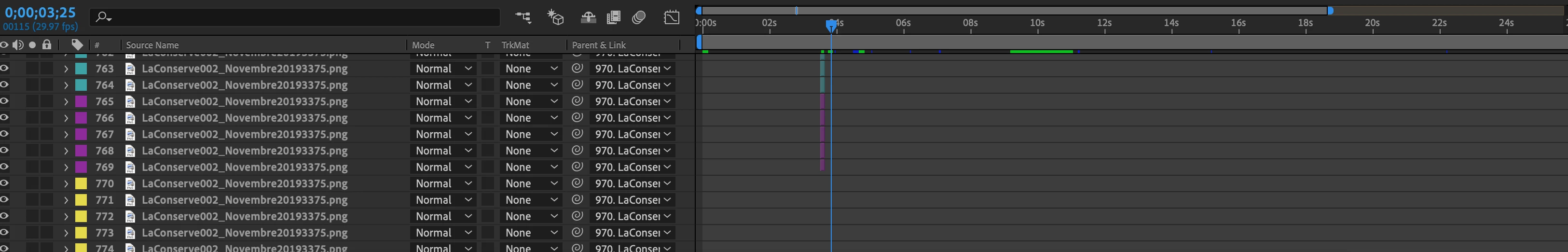

layers not showing on the timeline
  • June 16, 2020
  • 6 replies
  • 27353 views
see in the screenshot below, all layers at some point disappeared of the timeline. I tried to select all and click on u" to reveal properties and try to make them appear. It did not work. I still see they are there (on the left, the file is here) and I can see the elements in the video but I cannot control the layer to add keyframes... what happened?
thank you,

I had the same problem... After thousands of layers, some bars disappear.  What I did was pre-compose those layers that I can still see.  When I pre-composed a few hundreds, some of the layer bars appeared. Then I pre-composed some more until everything showed.  I pre-composed them in groups so it will still be organized in a way that I can understand their arrangement.

I also ran into this same issue: I have a comp containing several hundreds of layers. Any layer past 950 is not showing in the timeline anymore even though it shows in the viewer or also in the rendered file. I'm working on a GEOlayers map animation with hundreds and even thousands of realworld data each shown as a separate animated icon. I know about precomposing and I'd love to precomp these layers more efficiently but as far as I understand the way GEOlayers works, it's not possible to precompose these so called 'label' layers because of some complex expressions. As soon as I precompose these label layers the expression get broken and they lose their geo location on the map.
So my workaround is not to move the layers further up to show the layer in the timeline as described above (which works though). An easier workaround ist to just set some of the above layers that still show in the timeline to 'shy' and activate the main shy button. This way the shy layers disappear making space for the layers below to 'move up', showing these layers again in the timeline if you have to tweak them in some way in the timeline. Hope this quick workaround helps some of you guys.

I was having the same problem, I couldn't see the layers after 964, best thing is work with compositions but I'm not used to it, the solution I could find is to compose the layers I can already see, after that i can see the invisible layers

Hi Melanied95, I'm having the same issue. I contacted Adobe for help today and ended up doing a screen share with him. I also shared screenshots with him and tried my best to illustrate the problem.  The person helping me took control of my computer and tried a few things from his end. No luck, he was not able to help. He offered a few suggestions similar to other replies I see on this webpage. It was a challenging way to communicate and the problem is kind of hard to explain so unfortunately I had to try something else. This isn't the best solution, but I had to finish my project by end of today, so I just copied the layer that I wanted to edit and pasted it all the way at the top of the timeline, so it was above all of the other layers, and it worked! It also worked if I pasted the layer in the middle of two other layers that are still showing. For example based on your screenshot, if you copied 773 and pasted it right above 767, it would show up. That worked for me anyway. Give that a shot and let me know.
October 16, 2020
If you have a bunch of layers that don't show up, select the ones that do and Pre-compose them. When you do that your display should catch up and show you the layers that you could not see.
In practical terms, it makes absolutely no sense to have that many layers in a comp. Each comp should be a single shot or at most a couple of shots that have to be in the same comp because of a transition between them that you need to make. Look for places to cut. It's hard to convince people that AE is not a video editing app, but it isn't and was never designed to be one. The longer your comp and more layers you have in a comp, the longer it will take to render, the likelihood that the render will fail before it finishes wasting all of that render time goes up, and the more difficult it is to make changes to the comp that will give you a better product. If you are creating a 10-minute video filled with animations, different images, sound effects, different videos, you will be able to do a better job and finish the project in less time if you break the project up into 20 or 30 comps, each one expressing a different idea, and then you complete the edit from the rendered shots (sections) in Premiere Pro, or if your audio track is very simple, add all of your comps to a master comp and sequence them. Sequencing a bunch of nested comps is only a good idea if the render time is a few frames a second and not a few minutes a frame.

What are you trying to do with that comp? The first timeline screenshot shows layer 763 to 774 to all be the same image and the in and out points of the layers down to 769 appear to have their in and out point set about 1 or 2 frames apart. All the layers in that screenshot seem to be parented to layer 970. None of that makes any sense at all.
The second set of screenshots shows that you have at least 1104 layers in your composition. All of those layers also appear to be parented to layer 970.
You have far exceeded the ability of After Effects to properly display layer information. I've been working with AE for more than 25 years and I've worked on some incredibly complex compositions. I've created hours of animation, and I've never even come close to having more than 100 layers in a comp. The projects become unmanageable. A few years ago I did a presentation for a national conference where I needed to show a montage of 900 company logos flying through the street and then filling a stadium. I did it with one 900 frame image sequence imported as footage and 4 instances of particular. There might have been 10 or 20 layers in the incredibly complex comp.
Please tell us what you are trying to accomplish. Maybe we can help you figure out an efficient workflow. You are not going to be able to work with more than 1000 layers in a single comp on any system that I know of.
