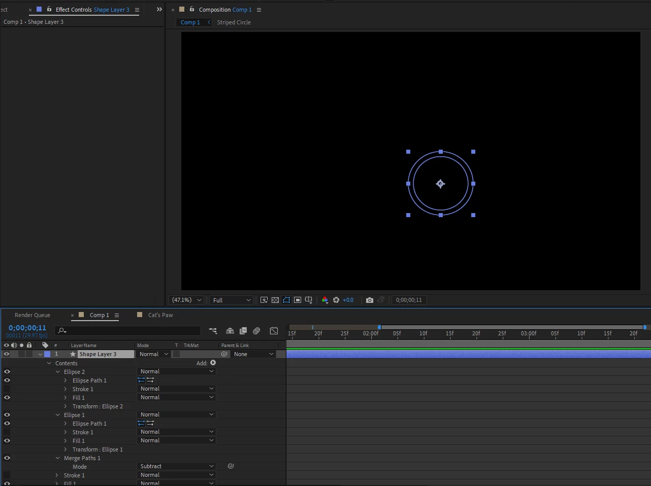

Hey there,
I'm attempting to follow this tutorial for the "Circle Splode" section starting at 4:54. I've created two elipses that have their scale keyframed to increase from 0 -> 100 with "Elipse 2" set to occur slightly later than "Elipse 1". According to the tutorial, I should add a merge paths to below the two elipsis and above the stroke/ fill (the stroke is disabled) and set the merge paths to "Subtract". Doing so however causes my shapes to completely dissapear.
I'm trying to create a bubble pop effect where a filled elipse expands, and then dissapears from the center outwards - like the hole of a donut expanding until the donut dissapears.

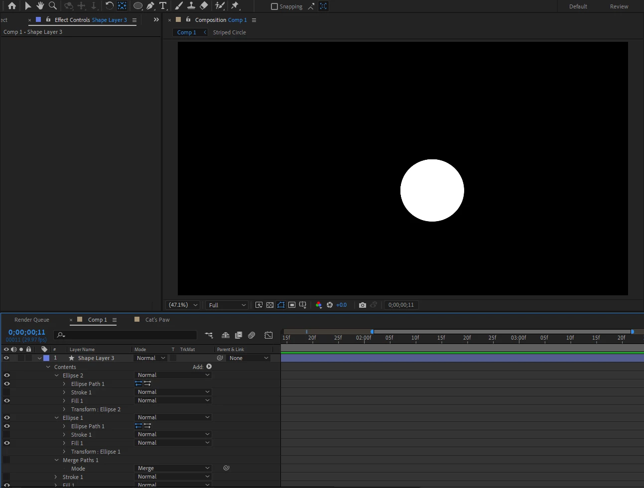

With Merge Path's subtract enabled:
Disabled:
Let me know what you think!
Thank you.

You are not showing the modified properties of the shape layer, but I think you have the layer order fouled up. The larger ellipse must be above the smaller one if you want to poke a hole in it.
Max8132Author
July 29, 2022
Hey Rick,
This worked! As long as the circle that is the larger at a given keyframe is on top, the merge paths subtract function works.
Thank you!
