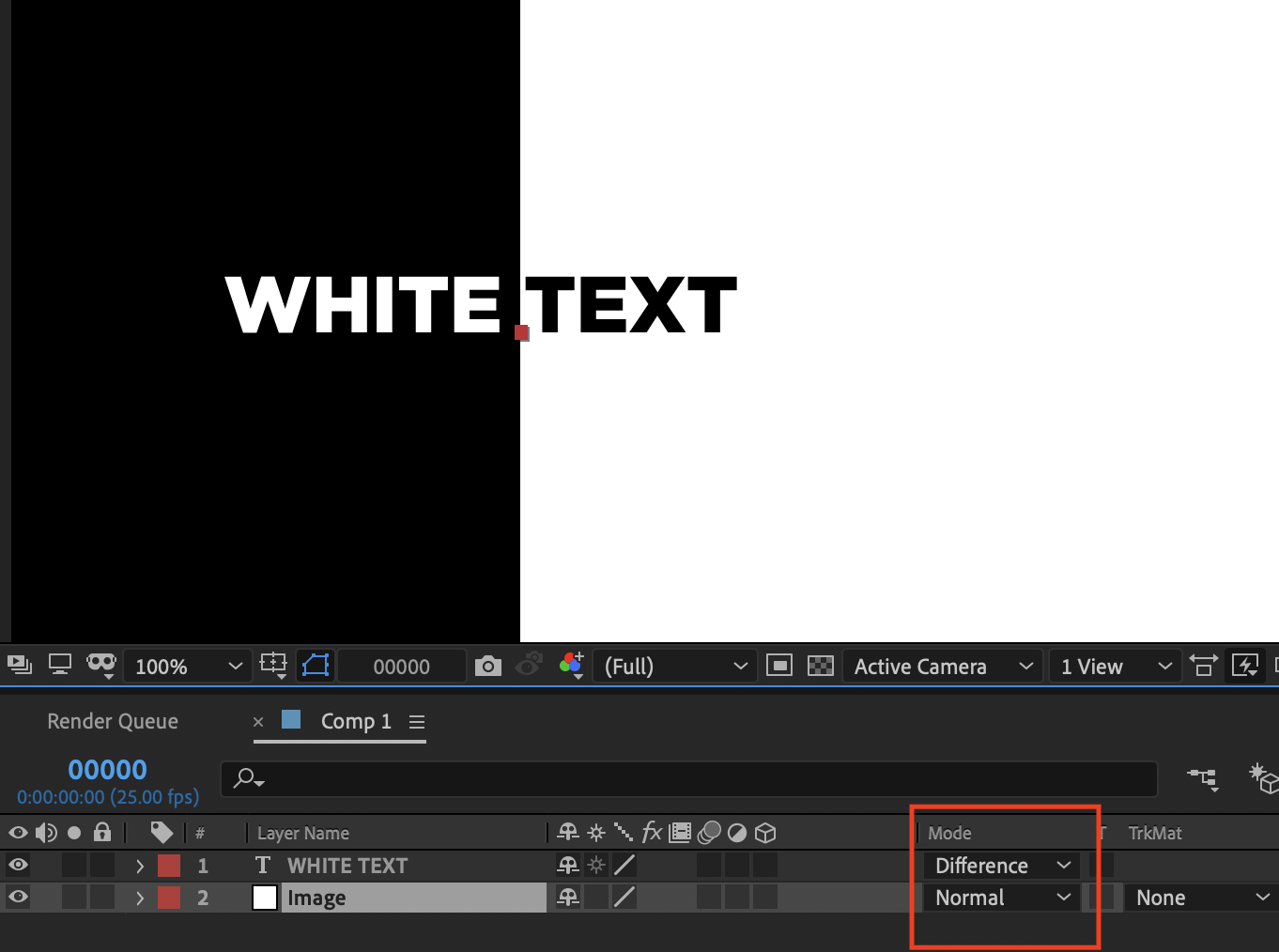

If I understand you, I think the only thing you need to do is to change the transfer mode of your test layer to Difference. Check the attached image.
