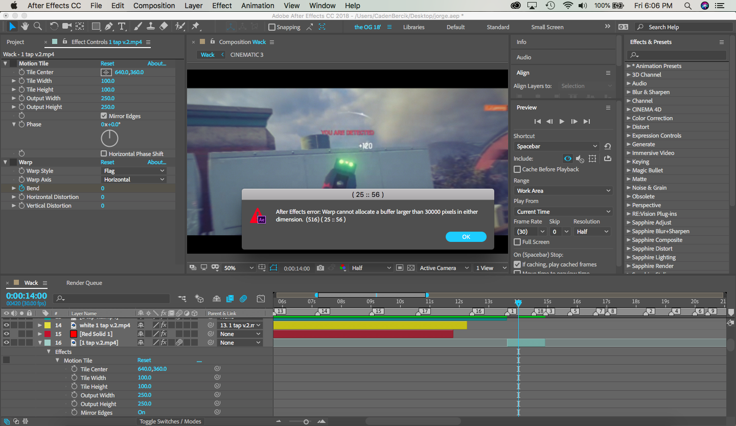

"after effects error: Warp cannot allocate a buffer larger than 30000 pixels in either dimension."
Community Beginner ,
Sep 07, 2018 Sep 07, 2018
Screen Shot 2018-09-07 at 6.06.39 PM.pngI dont know what i am doing wrong. but i keep getting this error in this same spot and clip every timeScreen Shot 2018-09-07 at 6.09.33 PM.pngScreen Shot 2018-09-07 at 6.09.14 PM.pngScreen Shot 2018-09-07 at 6.09.04 PM.png
43.4K
Community Expert , Sep 08, 2018 Sep 08, 2018
Most time is a motion tile issue, but your settings look ok, so did you have any adjustment layer or other layer over or behind your "1 tap v2.mp4" (it's not clear from your image) and if so try to check what filter you use. also try to delete the motion tile filter, purge your ram, Edit/Purge/All Memories and disk cash.

I have that problem, too. It happens at 06:02 and the layer doesn't even have motion tile.

its actually really easy,all you have to do is move the warp effect above the motion tile effects in the effects bar.thats all.thanks!

when i'm doing this black gap is coming in my composition what should i do??

you can just select the layers in the frame that failed and press ctrl+shift+c and highlight move all ... and highlight adjust duration ...  then double click on the new pre comp and press on the compsition up and add to render and render it and import it to ae then press alt and drag it to the new precomp and enjoy you can render it worked with me i hope its work

When you have motion tile on ur clip Pre-Compose it and make sure that you have ,,move all attributes into the new composition"

Move the warp effect above the motion tile effect.
