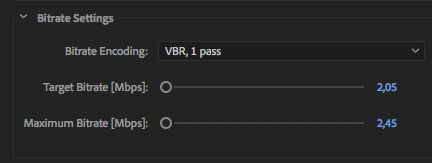

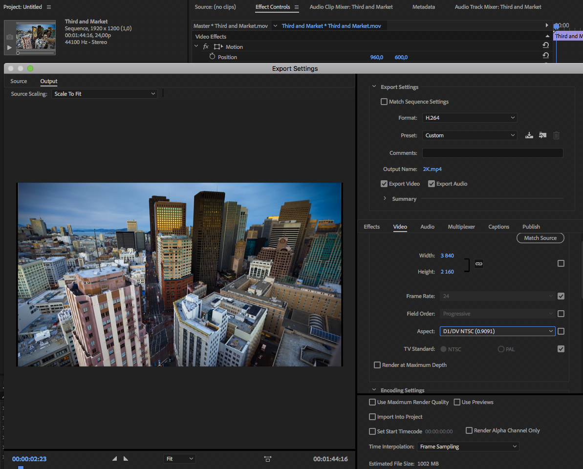

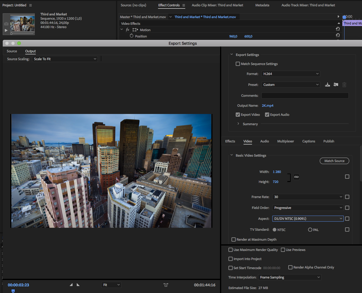

Mio I wouldn't recommend using an online convertor. You have virtually zero control over these files. Media Encoder should work very well and the large file sizes you are getting seem to be because of your output settings. Look for a comfortable balance between size and resolution e.g Youtube HD or Vimeo HD and if files sizes are too large decrease the bitrate slightly. If you aren't exporting finals to 4K or large format e.g IMAX you will really not see much difference if you drop a few notches on bitrate. However be careful not to drop too low as pixelation will be clearly evident. As an example when I have to output something for client review I use the Twitter Preset which has tiny tiny sizes but has acceptable resolutions with the bitrate slider set at 2. See screenshots below to understand what I am saying. These are from PP but similar functionalities in Media Encoder. So experiment with what works best for u in terms of quality and size. Mo
