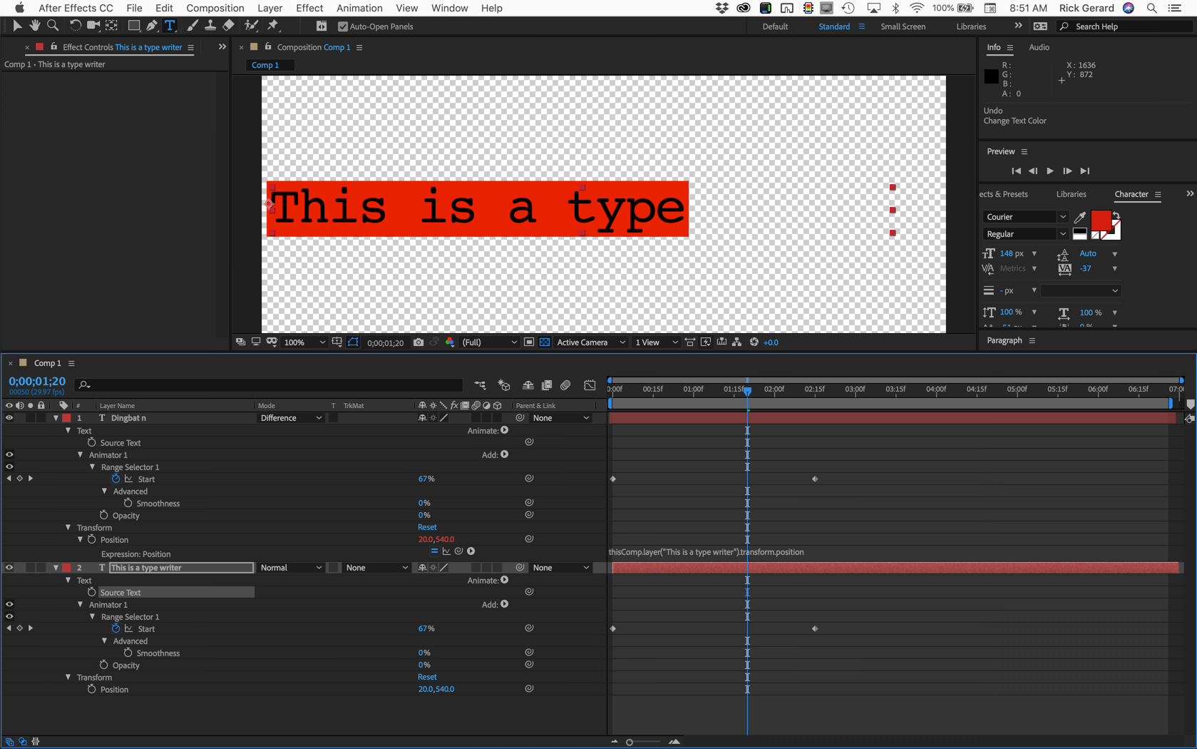

    Braniac
    February 28, 2019
    Right off the top of my head, the easiest option may be to use a monospaced font, apply the typewriter effect, duplicate the text layer, set the blend mode to difference to turn the letters black, change the of the top copy font to a dingbat and change all of the letters to "n" to give you a solid square, adjust the kerning, scale and baseline offset so the square covers the letters, add a stroke and you're done. If both text layers were green the project would look like this:
    If you want more control, add a shape layer rectangle bigger than the final text layer below the dingbat layer, set the dingbat layer to a track matte, move the typewriter layer to the top and adjust your colors. You'll get this:
    If you are not using a monospaced font then you could individually adjust the scale of each character using the character panel to line things up but I would probably just add a shape layer rectangle below the type layer and animate the horizontal width.
    The other option would be to use the sourceRecAtTime expression and try and modify the size by adjusting the horizontal size based on the percentage of the range selector. The top two examples took me about two minutes, it might take a half hour to figure out an expression to do the trick, but the expression would still require a monospaced font to work perfectly.

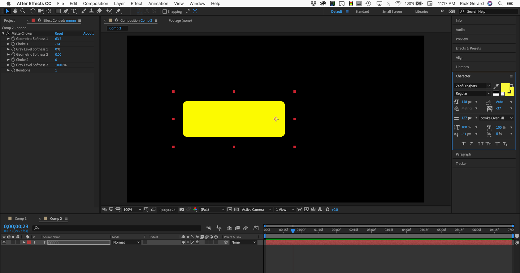

    Braniac
    February 28, 2019
    You would need multiple rounded rectangle shape layers to get multiple lines.
    Personally, I would probably use the duplicate text layer + dingbat track matte solution and add a stroke then add Matte Choker to round the corners. That would work with either solution 1, difference mode, or the track matte solution I posted above. This is a bunch of N's with the matte choker applied:
