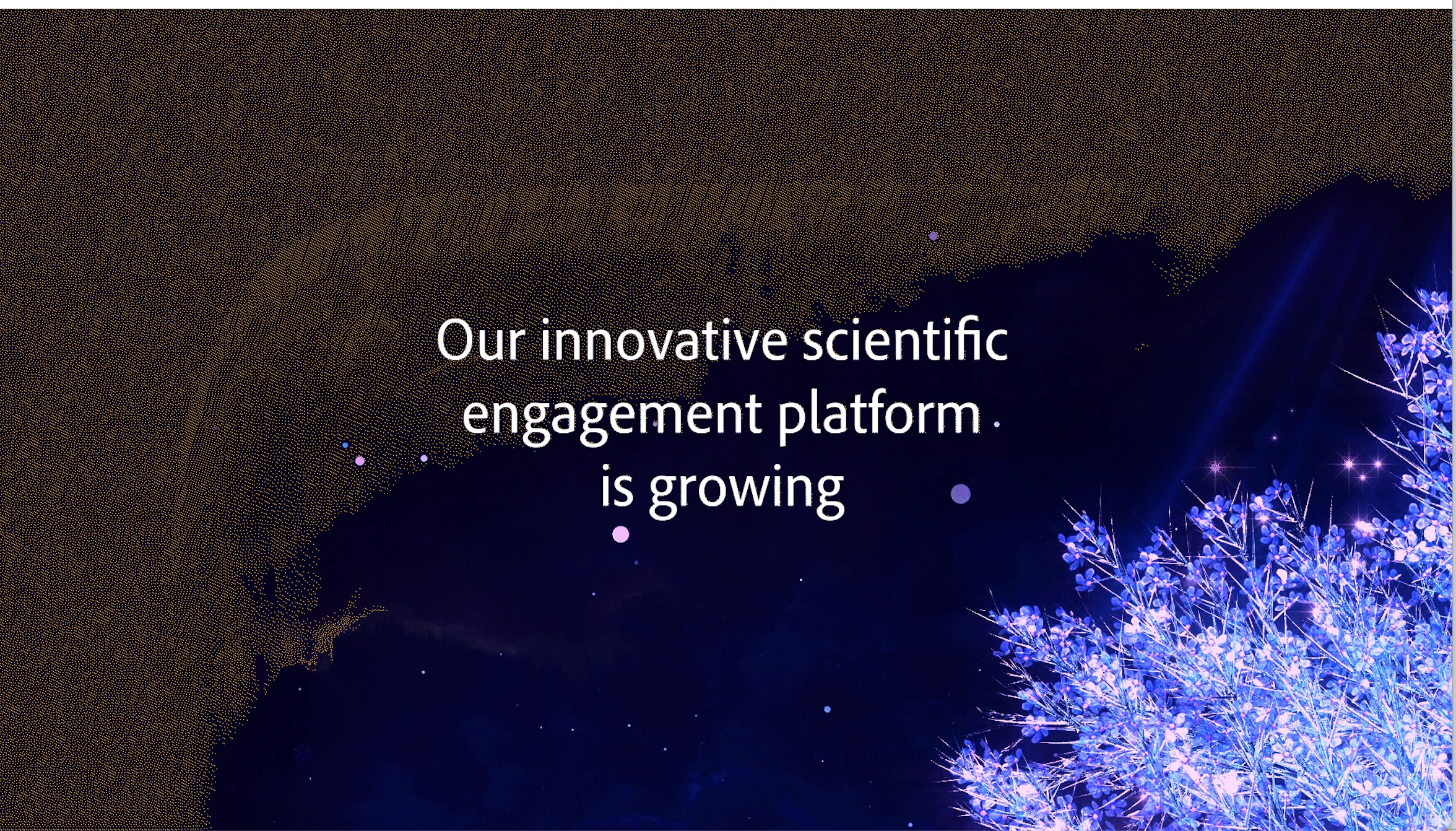

I'm trying to export an animated GIF from AE but I'm getting this strange orange pixel effect shown below in the top left of the still. It seems whenever I use a feathered mask or an opacicty drop, this happens.

Put a back solid as background layer and see if this helps.

My guess is that it has to do with the creaky old Animated GIF format supporting only 256 colors. When the composition includes a smooth transition, especially across a large area, GIF simply runs out of colors. After Effects tries to simulate more colors through dither patterns, so you see the side effects of trying to dither the few available colors into patterns.
In addition, the animated GIF export in After Effects, Premiere Pro, and Media Encoder is not the best available. You might also try running an exported video through the Gifski app; it does a better job of translating colors to animated GIF.
If Photoshop said there wasn’t enough memory, what is the duration of the composition, and what are the pixel dimensions of the frame? Larger or longer compositions can be too much for the old Save for Web code to handle.
GIF was not designed for high quality, high resolution video. It’s only used a lot because if you can’t use actual video formats, there aren’t many other options. But if it’s possible to use an actual video format with full color support such as H.264, these problems won’t happen.

That Gifski app was spot on, really simple interface and a much better end result, especially with the colours.
The video is 16 seconds long, HD, so yes, a huge file for PS to deal with I guess but all sorted now thank you.
