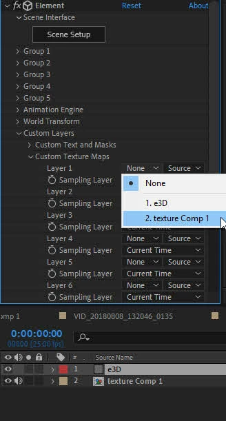

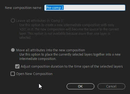

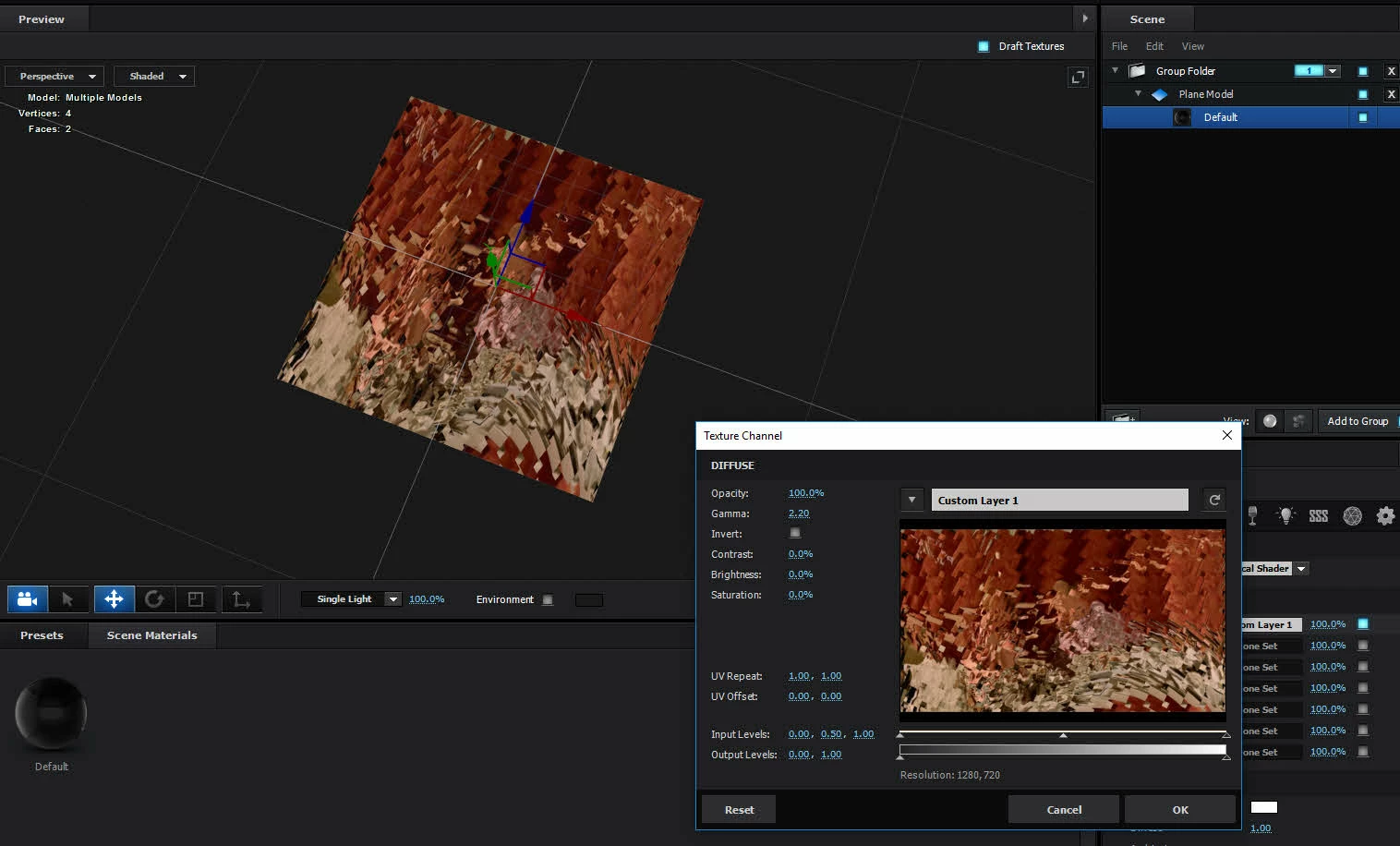

I recently tried to attach a texture to a Plane I created in Element 3D The texture was downloaded as a PNG file, precomposed and designated to the texture 1 slot properly and when I applied the texture to the Plane as a diffused texture I get nothing. I have tried to designate other textures as well and got the same results. I hope i am explaining this correctly and can get some assistance or suggestions to resolve this. I really want to work with this texture in this project.

    So you did prepare your texture and put it into precomp
    then you put e3D layer and e3D on it and assign your texture in custom texture in e3d settings
    after that in e3D settings you assign your custom texture to your pane
    And nothing?
    Is that what happens? But when you try to apply your texture in diffuse window (last picture bottom right corner) you can see your texture but you can't see it on your plane or you can't see it in settings either?
    And nothing?

    Hi
    This is correct. What I see on the Plane model is the default (white) texture.
    Thanks
    imeilfx
    January 24, 2019
    Ok. So maby try to import any jpg file (does not matter what) and try to use as a texture and check if it showes. If it works - that meat that Element can see custom textures but for some reason can't see that exact precomposed texture of yours. Then we will look for that reason.
