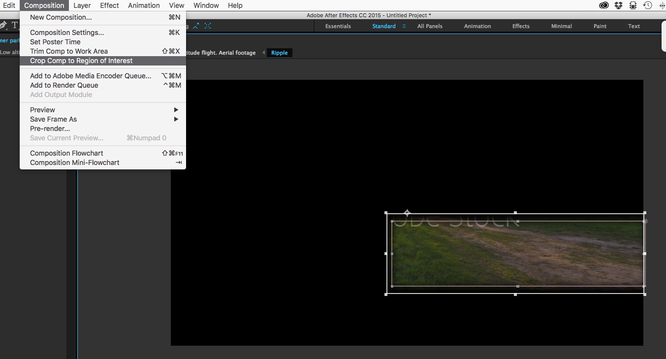

    Here comes the trick that makes corner pin easier to use and the composite easier to make. First press the f key to reveal the mask feather and set it to a value of about 10 pixels. Next, set a Region of interest that just covers the masked area and the feather and crop comp to the region of interest.
    Move back into the main comp. Your Ripple comp will be out of position. Set the blend mode to difference to help you position the Ripple comp precisely over the original footage. You should see nothing but black. You are lining this layer up just to help you position the guides .
