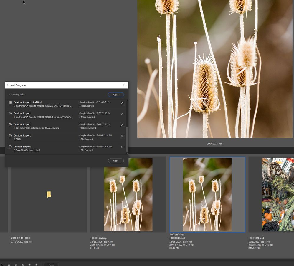

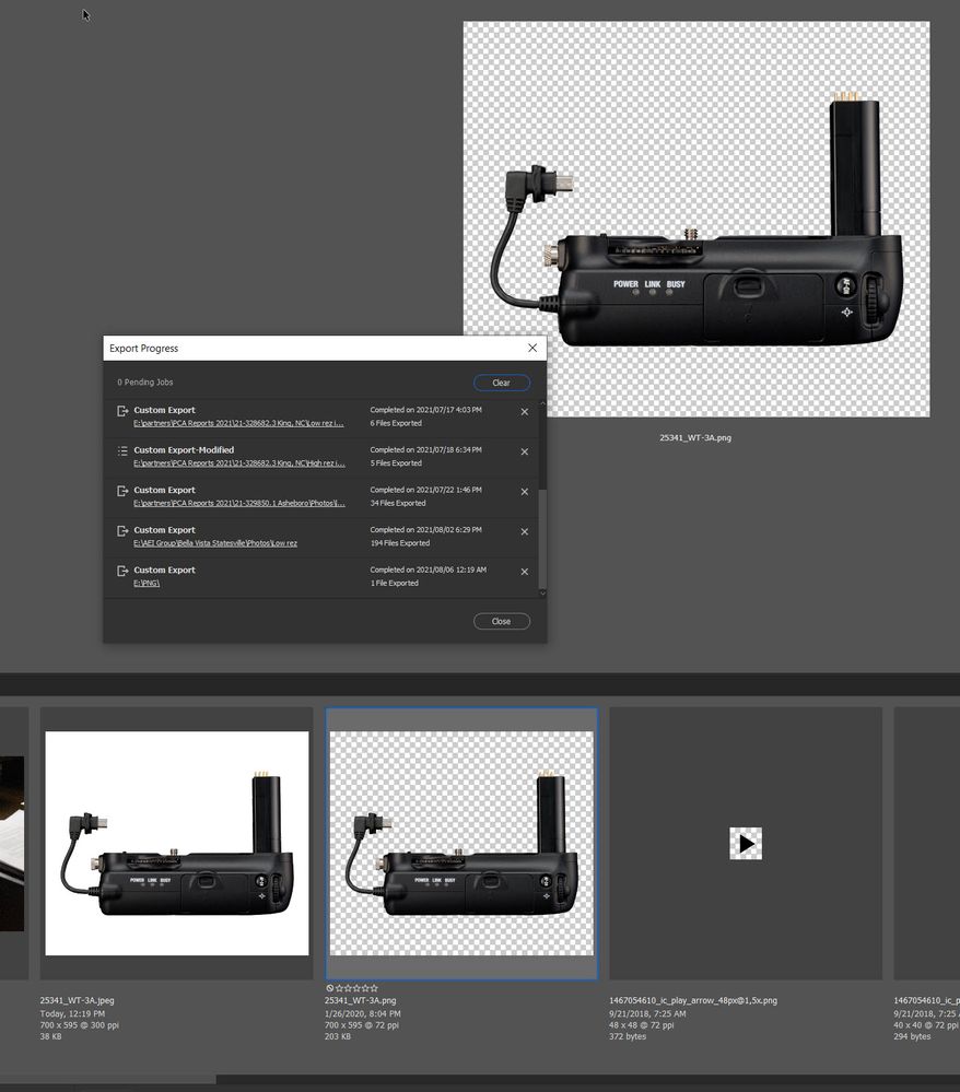

Aug 06, 2021 Aug 06, 2021
You may want to reset your preferences or reinstall Bridge.
All those export formats work just fine here.
See attached screen shots2021-08-06_12-21-27 psd to jpeg.jpg2021-08-06_12-19-48 png export.jpg
