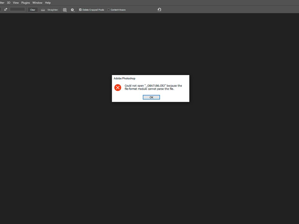

I think I found a bug in either Bridge or Camera Raw. I open a raw file from Bridge, do my normal adjustments, BUT this one time I used the healing brush to remove a dust spot. And when I did when I clicked Open in Camera Raw to send it to Photoshop I got the message Could not open "_08A7186.CR3" because the file-format module cannot parse the file. I went back to Bridge and right clicked and under Develop Settings I clicked Clear Settings. Then I could open in Camera Raw and open it in Photoshop.Adobe.jpgexpand image
