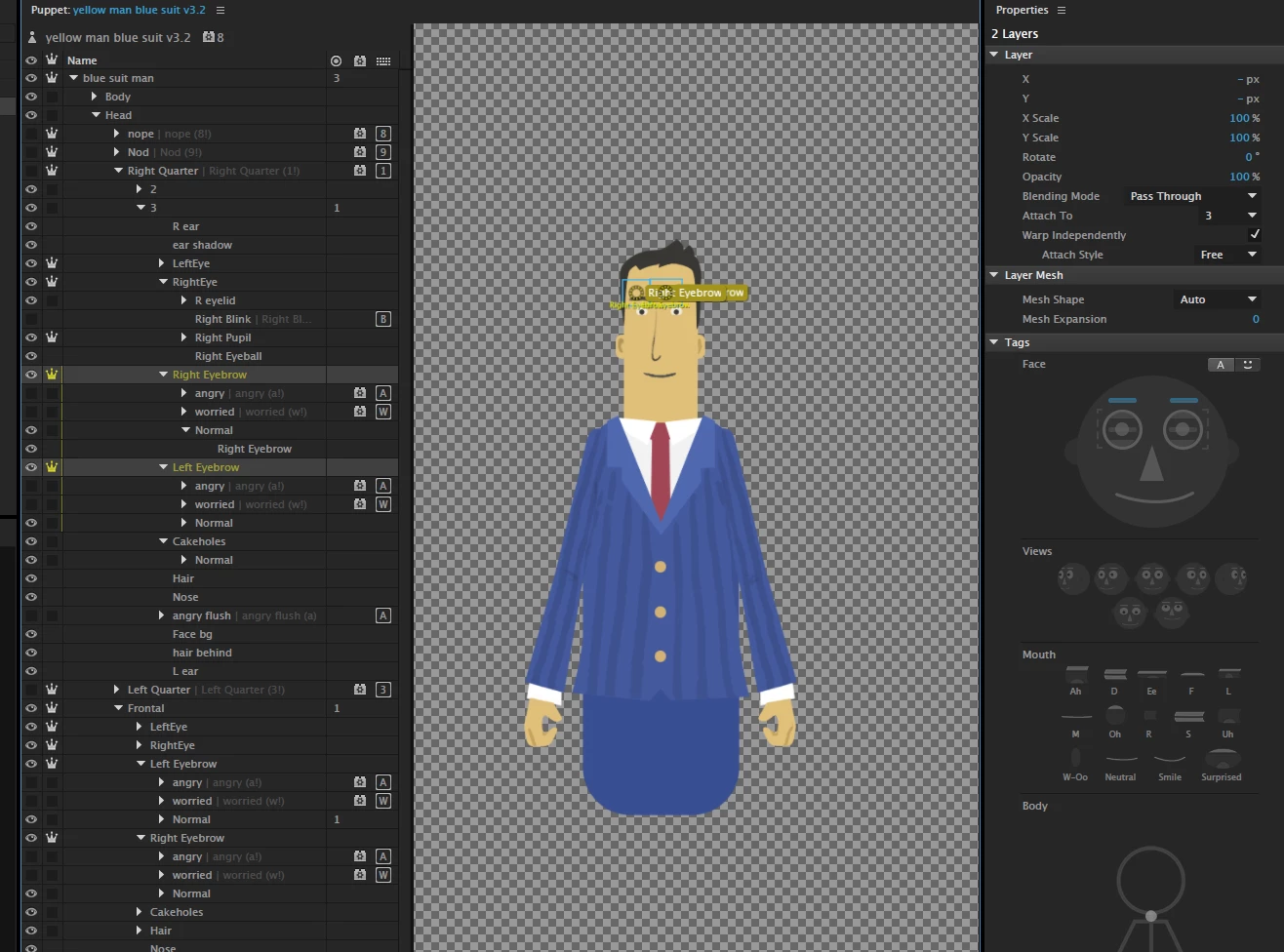

My eyebrows are animating fine on the 'Frontal' view but not moving up and down on the 'Left quarter' and 'Right quarter' views. There are alternate angry/worried states but the parent group of each is def tagged as 'eyebrow'.
Can you think of anything I might have missed or a reason they might be remaining static?

When I remove the transitional '2' folder and the Quarter view cycle layer behaviour, and add the Face behaviour to the Quarter view, eyebrows do work. But I wanted a smooth turn transition. Any ideas?

Try untagging your "Left Quarter" group and instead add the tag to your "3" group inside. When you add one of those view tags, it should always be the level directly above where all your face stuff is - in this case, that's the 3 group that cycle layers lands on.

Are you talking about the Face behaviour tag? I tried to get your advice working with the transitional "2" folders and cycle layers, but it was just too dodgy looking and the quarter view eyebrows were all over the place!
Weirdly, eyebrows worked fine on the Left Quarter with Face behaviour tag on "3" but it only works on the Right Quarter if the Face behaviour is added to the parent "Right Quarter" group, not "3".
So it's working, technically, but I have no idea why the Right Quarter eyebrows won't work with Face behaviour on the "3" level, only on the level above. Would love to know why, if you could take a quick look at the updated puppet.
I *could* lose the "3" subfolder but was holding out hope for getting a transitional "2" view working at some later point.

You need to add Face behaviours to the eyes in the alternate views for them to be reactive. Hope this helps :-)

I just tried that - not sure if you literally meant add the Face behaviour to the *eyes* but that made it go very weird!
Adding it to the Quarter view or even the '3' subfolder within did nothing for the eyebrows unfortunately.

oksamurai​ - Here's a link to my puppet rig (39mb sorry!) - see Left Quarter (1!) - blink and lip sync are working fine so why aren't eyebrows animating?
The eyebrows have angry and worried states as well which works fine on Frontal but not on Left Quarter.
