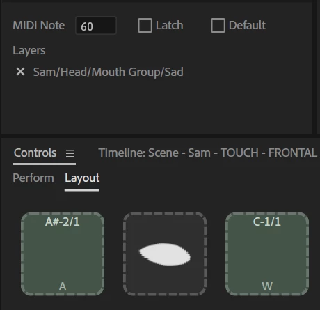

You can assign a MIDI event to triggers in one of two ways.
  • You can go into rig mode, set the Controls panel to "layout" mode, click on a trigger button then press the MIDI key on the keyboard etc. (See the squares at the bottom on the image - "A" (angry) is set to note A#2 (aka B-flat) in the second octave. The "/1" means MIDI channel 1.
  • In the trigger panel there is also a "MIDI Note" text box. This is the underlying MIDI note number. But I don't see the channel number.Can you edit it using the "MIDI Note" checkbox? I tried 72/3 but it failed.

    In the trigger panel, only the midi number shows, corresponding to the key on the keyboard. That is a unique midi number which relates to a key on, say, a grand piano. In the timeline control panel, the midi number doesn't show, only the note and octave. What it looks like seems to depend on the midi controller in use. For instance, here is what it looks like for me. With another controller, an old Roland keyboard, it looks the same except the "16" is replaced with a "1"

    I *think* the /1 and /16 represent the MIDI channel number (internally a number between 0 and 15, but seems to be displayed to humans between 1 and 16 - I might need to adjust my code!).  I believe the unique identitifier is the combination of Note number (e.g. 106 which is A#7) AND the MIDI channel number.
    That is, if you bind C3 on one keyboard to a trigger, then C3 on your other keyboard will not trigger it (if the two keyboards were given different channel numbers). Could you quickly test that for me please with your two keyboards? Does the same note on both keyboards trigger the same trigger?
    I don’t know how channel numbers are allocated to devices. I assume its part of the device itself?
    Further, I think if you pick a trigger that is not bound to a keyboard and type in a note number by hand, it will default to channel 1 (internally 0). You cannot use the NoteID field to bind other channel numbers (which look like a defect to me).
    That would imply that the trigger panel should really be displaying both the note number AND channel number. I just wanted to check before submitting a feature request to get it added.

    If the channel is the same, then either keyboard will activate the trigger no matter which device was used to input it. Most controllers these days have a channel adjustment capability, so even though the internal default is to channel 1, any keyboard can activate if the user is aware of this. Still, it would be helpful to alert users to this topic. The same thing may be said about virtual midi devices, which also have channel choices, although I haven't yet found it to be a problem. I'll have to give that a test as well.
