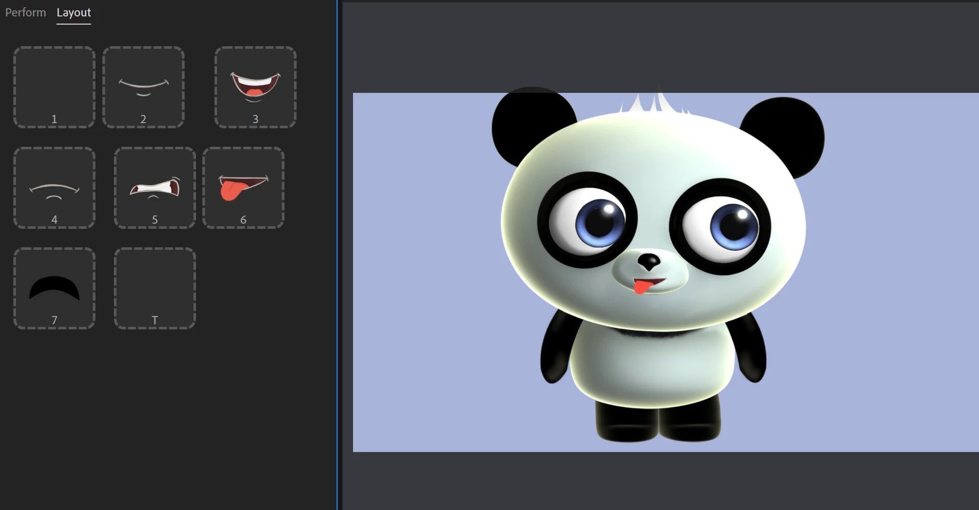

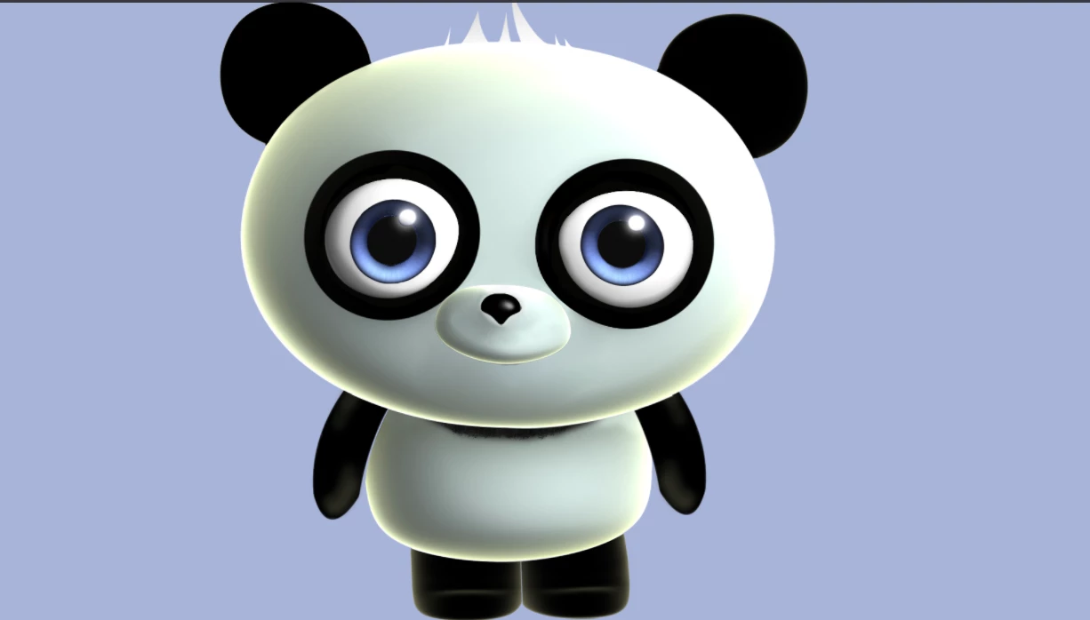

My mouth Actions are not showing when I switch to recording or stream. This is the settings. The lipsync isn't reading the behaviors. It was working before but now not working so I think I clicked something by accident.
This is what it looks like on Record or Streaming.
But when I press triggers, they work just fine. Is there any easy solution that I know somehow I'm messing it up please?

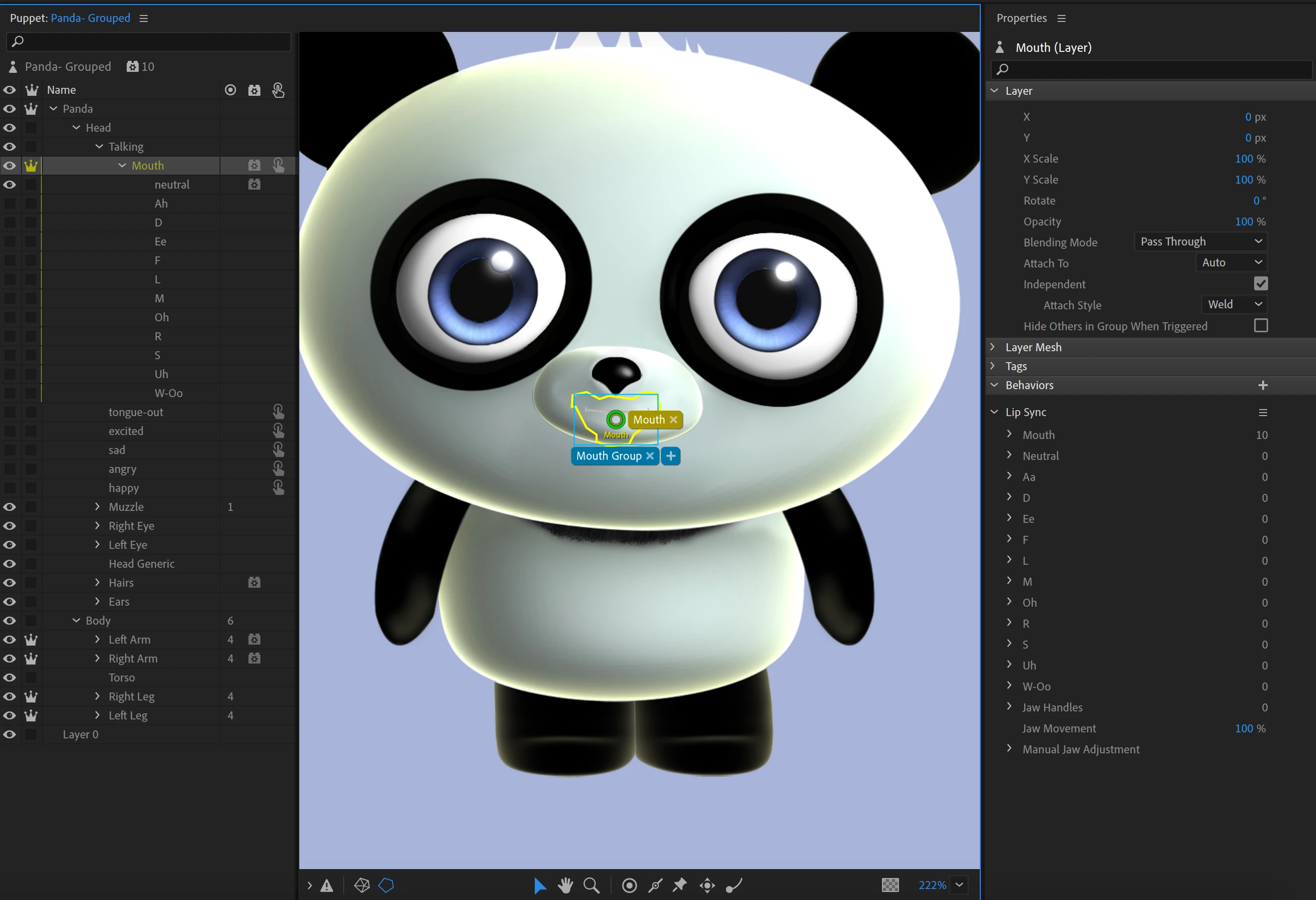

TheOriginalGC
February 10, 2022
I don't understand your layer hierarchy. What is the purpose of the talking layer and why aren't any of the parts of the mouth swap set within the mouth layer? That's the first place I would look for issues.
February 10, 2022
Is it tagged as "Mouth" on the body? Maybe you clicked that off by mistake.
MasterTheWong
February 10, 2022
Sorry, I don't get your question. The mouth is tagged as 'Mouth'
February 10, 2022
Is it highlighted like this:
