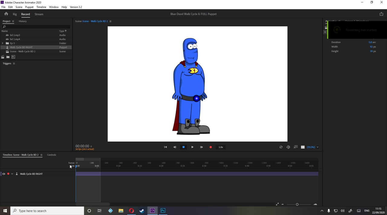

Hello me again! I'm getting there with this puppet however im noticing a "jerk" movement when initiating the walk behavior (using left and right arrow keys) doesnt seem to happen every time though - anyone any ideas?
big thankssss!!!
https://vimeo.com/460504680

In your walk behaviors, try setting the 'Start/Stop Easing' to 0sec.
It is trying to ease your puppet to the original rigged state, and you are likely starting and ending the walk with a pose you have set.
Hope that helps you MrRadical!

My *guess* is there is something about the head or top of shoulders that is making the top of the puppet "stuck". The head does not move up and down as it walks. What then happens (is my guess) is the first frame the walk and the "stuck" behavior are fighting it out and the other one wins for the slightest of moments. (E.g. due to the ramp up time Smidio mentioned) Then the "stuck" behavior wins. So you get this single frame of strange jitter. The difference when walking in the other direction because perhaps the handle or whatever is causing it to be stuck is in a different place relative to the other handles, so it behaves a bit different.
So how to fix it. Well, if I am right, you would need to find and remove the "stuck" handle. E.g try deleting half of the layers on the head (like the eyes and eyebrows and mouth and nose) and see if the jitter still occurs, then delete more, until there is nothing left or the jitter stops. Then undo and put them back - basically by trial and error see if there is something you delete that makes the jitter go away. I consider it a highly scientific method of "trial and error until you get lucky!"

Thanks for your help so far Alan. There is actually a head bobs on both sides albeit very small. Though i think you might be right about the handle issue - ill have to back track and find out where that particular issue lies and try to sort however, the instruction left by smidio has worked for now 🙂 ta!!!!

Wow how simple was that?! honestly that was driving me crazy - i had it set to a relitivley small ease 0.2 soon as i reduced it to 0 it solved this issue, amazing how such a small change can have such an effect. many thanks!!
