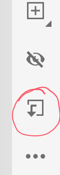

I have a work around that I use.
Create a new fill layer above your line art and make sure it is set to the right type - I use vector. Then select the icon that looks like a square with an arrow pointing down on the right(shown below). Hope this helps 🙂

Basically, it creates a mask layer above your original lineart 😊

Thank you, that worked!

I do not understand how this worked...but it did!  thank you

Glad it works for you!
