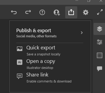

Are you using "save" or "open a copy" to transfer your artwork from one to the other?
When you "open a copy" from Fresco to  Illustrator (desktop or mobile) as opposite to export, it will keep the paths as filled shapes (as opposite to paths with a stroke). But they're still vector shapes as long as you don't flatten them.

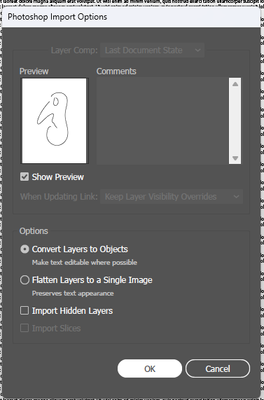

(.psd supports vector)

Moving from Fresco to Illustrator is easy, the opposite isn't. You'll need to export as .PSD as Fresco doesn't read .ai files (you'll need to "import and open" as .psd), and the illustrator export flatten the .psd as raster.
