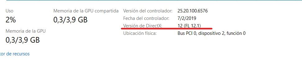

New Here ,
Oct 31, 2021 Oct 31, 2021
Buenas, verifique lo que usted me indico, mi versión de DirectX es 12.1. ¿Podria ayudarme a encontrar otra solución?

Adobe Employee ,
Nov 01, 2021 Nov 01, 2021
Thanks for checking this. I would request you to update Fresco to v3.0 or try reinstalling it and see if that helps. If this doesn't help, please share your Device & Windows specification screenshot.
Also, you may try the suggestion shared on these community posts (https://community.adobe.com/t5/fresco-discussions/fresco-stuck-on-quot-loading-documents-quot/m-p/11...) (https://community.adobe.com/t5/fresco-discussions/stuck-on-quot-loading-documents-quot/td-p/11972791) and let us know how it goes.
I will be looking forward to your response.
