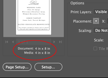

Hi, I've watching every tutorial on youtube, and read everything on Adobe about how to add a bleed successfully for printing. Yet when I go to print, it still shows up without a bleed and won't print with a bleed to the edge. What am I doing wrong or missing?? Truly, I've done everything.Screen Shot 2022-04-27 at 11.13.13 AM.pngScreen Shot 2022-04-27 at 11.13.17 AM.png

Apr 27, 2022 Apr 27, 2022
Please show the Marks & Bleed print options.
OK, we posted at same time.  Change your paper size. If not coming up download the driver for your printer model.

To print bleed, you have to print on paper that's larger than your page size.

Good catch! I missed that.
Bleed requires a larger page size than the actual document, that's the point of bleed. Print on larger paper, cut to the final size.

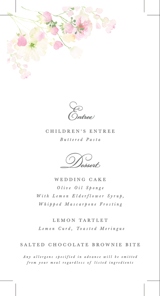

thank you all! i tried all of that and still isn't working. i also downloaded the driver again for my Epson printer but it's not allowing me to change the "defined by driver" size to the size. I did change the size in page setup though which usually always works. And even when I save as a pdf, it doesn't extend for the bleed. losing my mind!Screen Shot 2022-04-27 at 2.59.01 PM.pngScreen Shot 2022-04-27 at 2.59.06 PM.png
quote
even when I save as a pdf, it doesn't extend for the bleed. losing my mind!Screen Shot 2022-04-27 at 2.59.06 PM.png
By @jessicag3258874
^That certainly looks like it's got the bleed.
