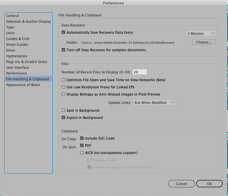

Apr 23, 2020 Apr 23, 2020
Hello, I hope this info can help someone. I was having an issue in Illustrator 2020, Version 24.1. on an iMac running OS High Sierra. Everytime I saved a file, the SAVE feature was still black instead of greyed out. I had to close the file and then it would ask me again if I wanted to SAVE. This seemed to be the only way to make sure my changes were saved. Adobe Support tried everything up to and including a Hard Reset of the Application and reloading Illustrator. This caused me to have to redo all my setup and reinstall 3rd Party Plug-ins. It worked for a couple of days and then stopped. I finally found the issue: Adobe has a Beta Preference dealing with saving. Once I unchecked this, all has been working normally. Uncheck: Optimize File Open and Save Time on Slow Networks and Uncheck: Save in Background
Hope this helps! Sheryl
