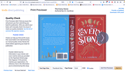

Then, when I upload to Amazon's KDP Print, the KDP previewer shows the colors getting noticeably muddy and dull.
Note—this previewer is a fairly accurate predictor of how the printed version will look. See the pic of proof copy below, which got even more brown in tone.

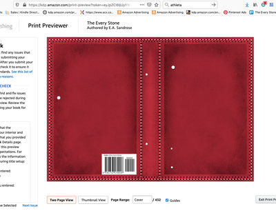

  • Just out of curiousity, I tried swapping out the background layers from the old antique book cover jpegs to rectangles the same size in primary CMYK blue or red from Ai default swatches. They also get muted in the KDP previewer.

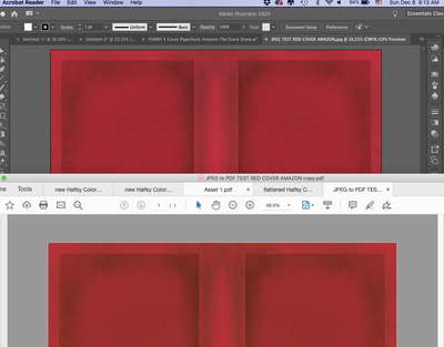

    • Also interesting--if I open the JPG of the red background looking just how I want back into Ai and save a copy as a PDF, it goes back to the muddy orange quality. See pic:Screen Shot 2019-12-08 at 8.13.18 AM.png
