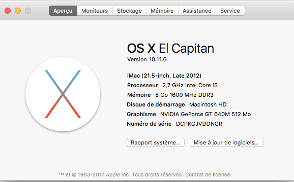

Dec 01, 2017 Dec 01, 2017
I cannot repeat your problem.
Which Mac OS are you using?
Did you try to reset your Preferences?

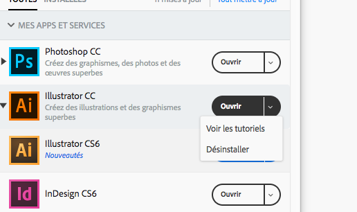

If everything fails, you can install an older Illustrator version.
Go to the CC app and click the arrow next to Open and choose Older Versions.

Alors j'ai encore un problĆØme, chez moi, Ƨa ne me propose pas les anciennes versions quand je clique droitCapture d’écran 2017-12-01 Ć  15.45.59.png
Strange, try to quit the CC app and reopen it.
Or else D“sinstaller Illustrator CC and see if you can install Other versions.
New Here ,
j'ai tout quitter les CC mais Ƨa n'a pas marchƩ, le plus bizarre c'est que cela m'est proposƩe sur mon petit MacBook Pro !
Your Graphic Card is the problem from what you have shown. You will need more graphic memory to work with current versions of AI.
