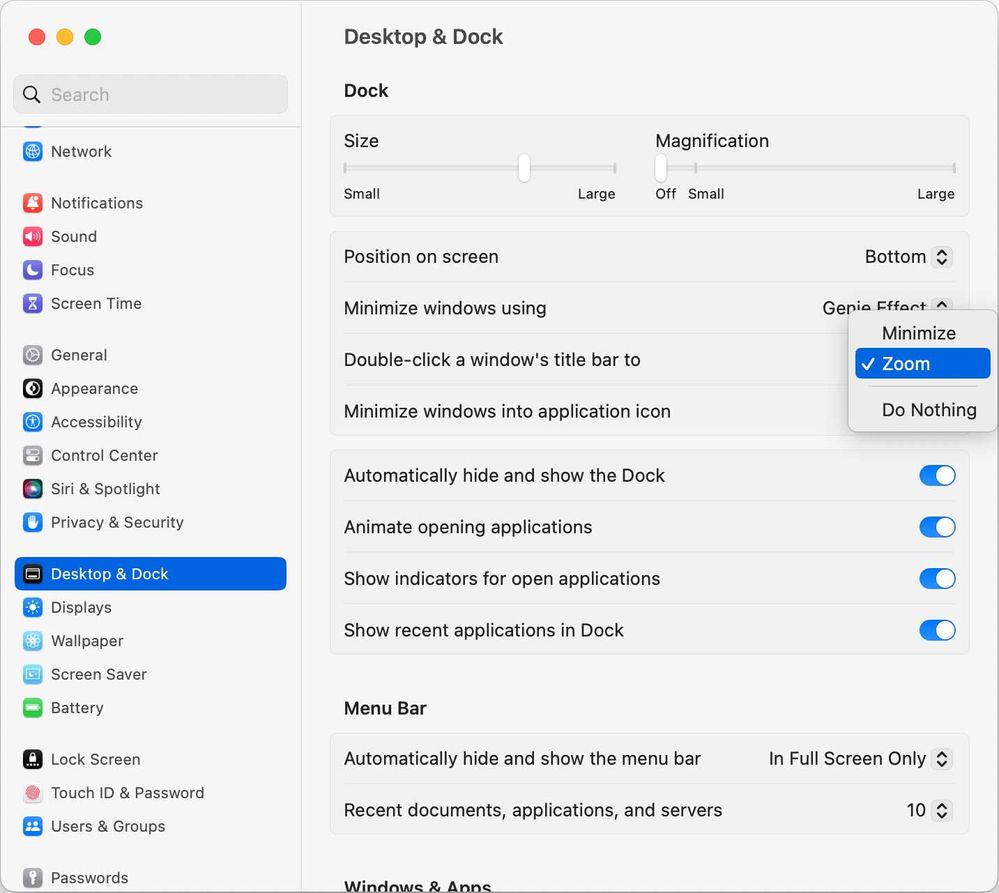

If any part of a window title bar is visible, try either pulling it to the right or double-clicking it. Double-clicking a title bar should maximize it to the display size, if in macOS System Settings you have “Double-click a window’s title bar to…” set to “Zoom” as shown below.

Moom is a lifesaver. I create keycommands to resize all windows when hooked up to my 32" monitor and when it's just me and the MacBook. I had the titlebar set to Zoom, but set it to minimize and will try that when it happens again. Set to zoom it does nothing since I have the Illustrator window set to fill the screen, but I just notived Presentation Mode and that might also do the trick and I can set a keycommand for that.
