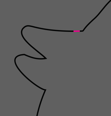

I am trying to achive following effect for my paths. I need to divide my path into 2 separate colored paths. For example after each 200pt long black path is a 20pt long pink path. For a simple shape as a circle i have found a simple solution, that would work for me.
I use a pattern brush  and can expand the apperance to have unique paths for black and pink. Unfortunately this solution isn't working for more complex paths beacause i require  a long pattern (280pt balck and 1.5pt pink) and illustrator cant handle this on corner points. I get the following result. On the left is the original path and on the right is the pattern brush applied.
After adjusting the corner options of the pattern brush, i get a better result, but  illustartor applies the pattern between corner points, which leads to results like this:
The whole pattern is compressed to a mush shorter path than wanted as you can see on the curved path. On the right side is the pink path, which should be much longer or even not on this position regarding the whole shape
Is there a way to achive it in Illustrator or even a script that manage to do that?

To clarify the "one" path - as shown with the simplyfied circle. In the end i need the whole path of the circle without gaps and overlapping paths. Its not one path but the multiple segments complete the "one" path.
I already tried this aproach, but pathfinder wont return a valid result.
So i create a copy of the Path and convert this to a dotted path with a 280pt gap and 5pt pink dash.  Visualy it looks right.
As soon as i expand the view and substract it from the path underneeth it i get this result:
Adjusting the width of the pink dotted path does not resolve this issue.
Feb 08, 2022 Feb 08, 2022
Dis you try to increase the precision in the Pathfinder panel menu?
Explorer ,
Yes, same result event if i change the precision from 0.028pt to 0.0001pt.
